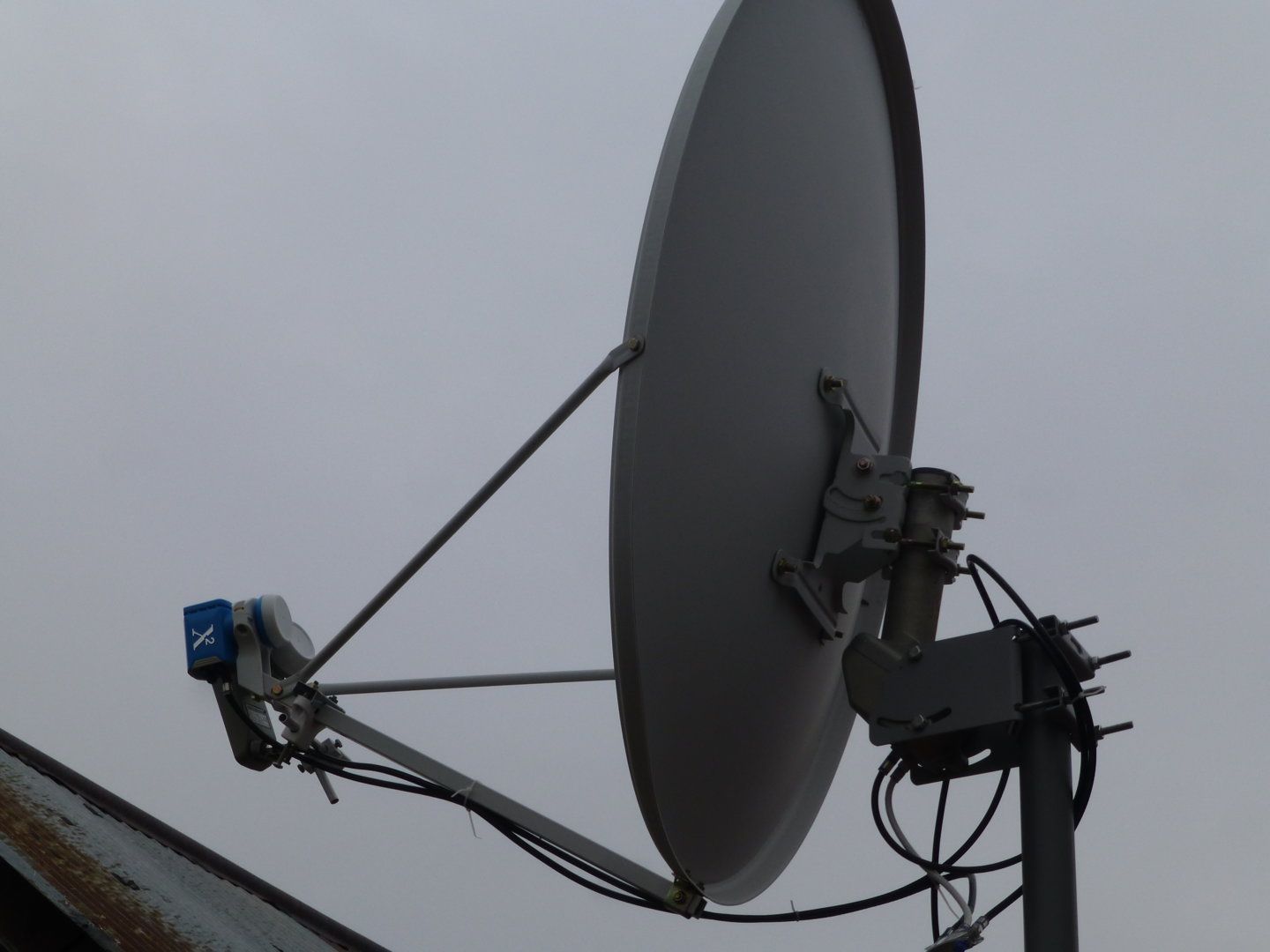

Following your lead, today I installed an offset circular LNB on my motorized dish. I have now scanned in 537 TV and 173 radio channels from 31 transponders on 91W Nimiq 6. Likely they are all scrambled but I will go through them now to check. I used 95W to get the dish pointed then used the 4 degree offset to position the circular LNB as you described. Now I will go looking for circular transponders.

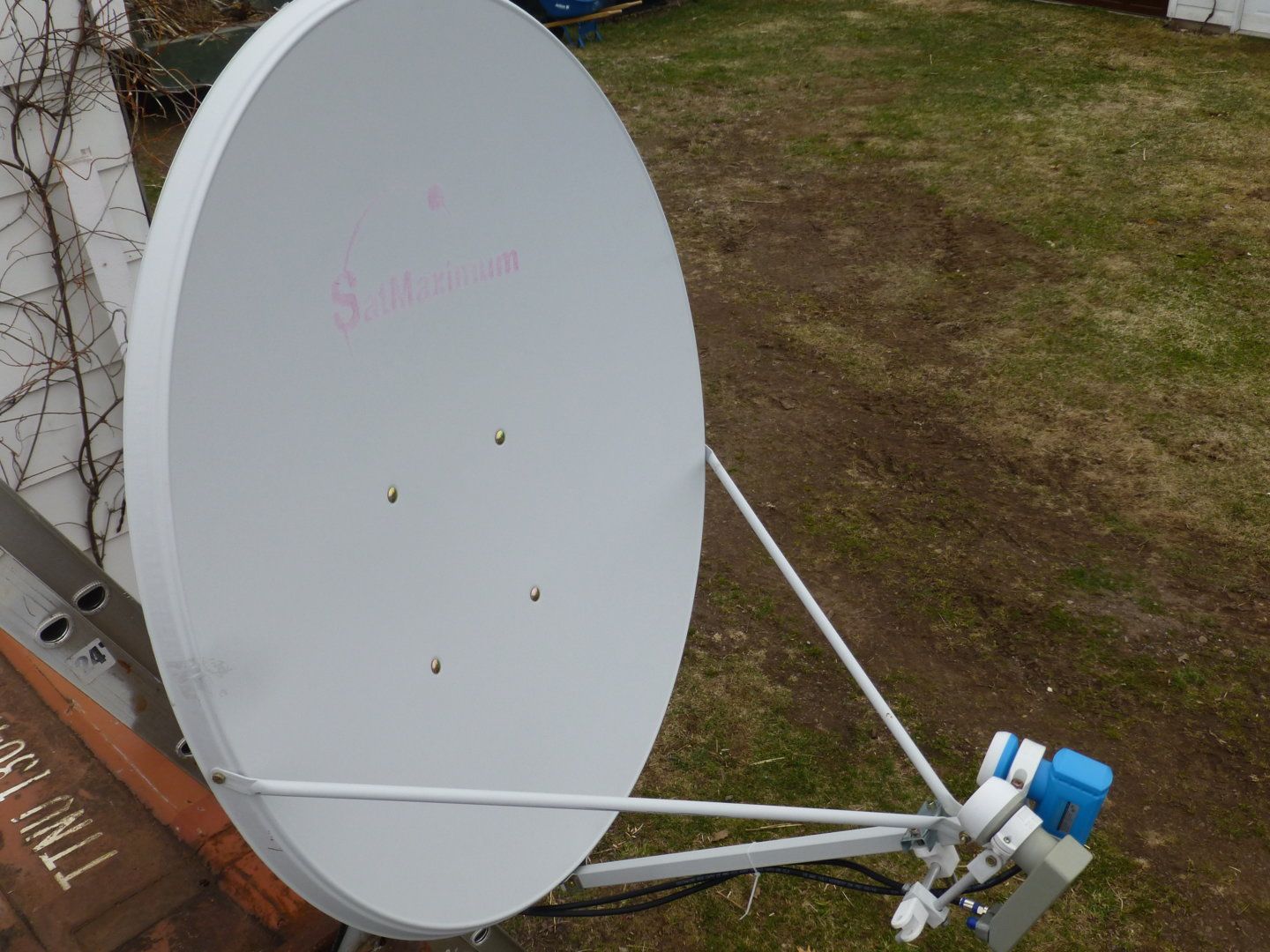

Pictures as promised of the finish KU USALS satellite with a Universal KU and Circular KU LNBF.

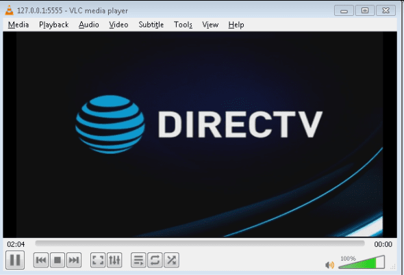

Well, thanks to some very helpful people on another forum, and a generous user, I am now able to lock and view FTA DirectTV signals. DirectTV signals won't even lock on most Tuners. Then, there are other tuners where you can lock the signal, but you cannot get any DATA from the Tuner. Then there is a combination of software you must use. In another words, there is nothing about this process that is Easy Peezey.
But, once you get it all working properly, then its pretty smooth to check all the transponders and SIDS.

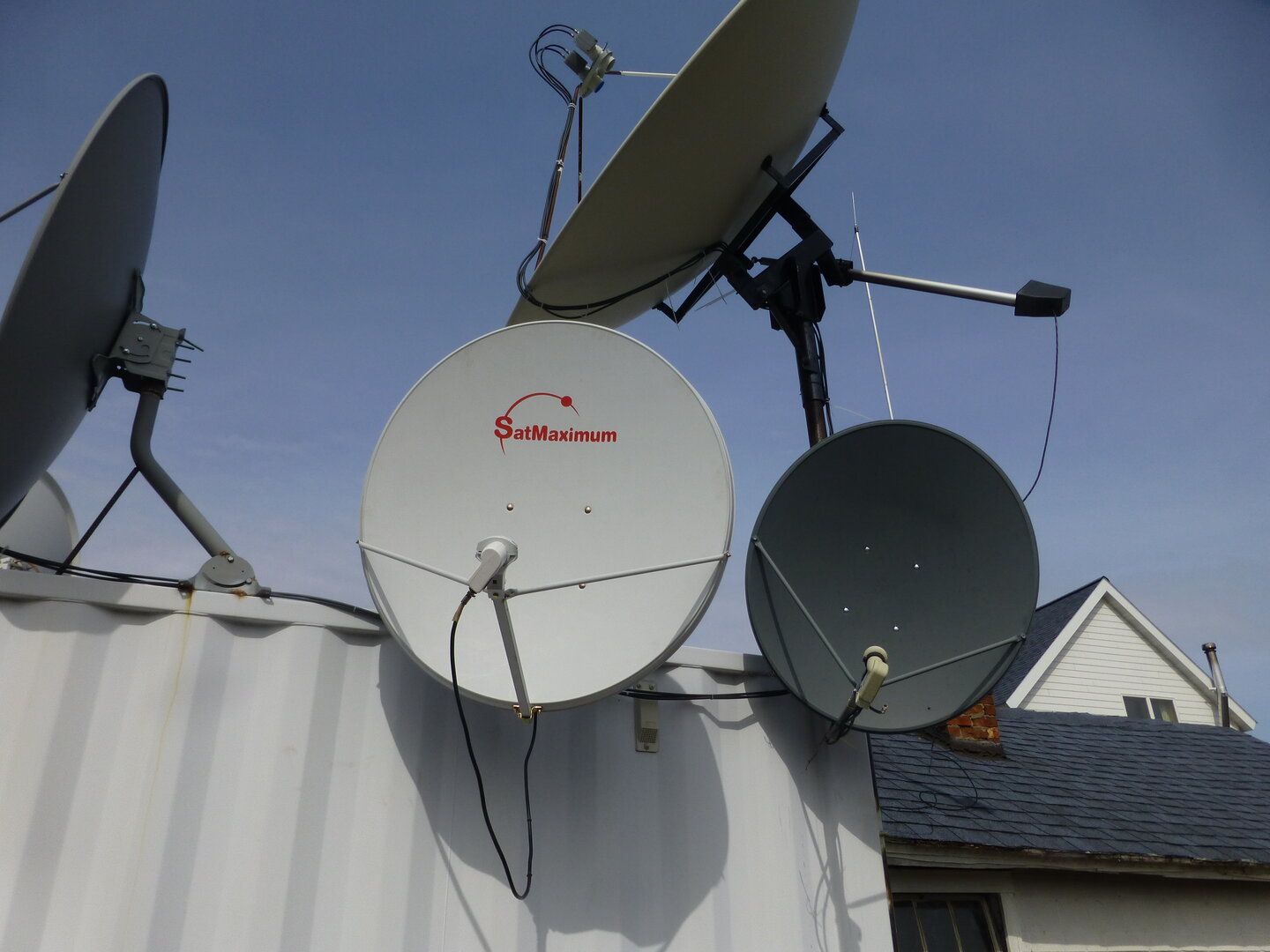

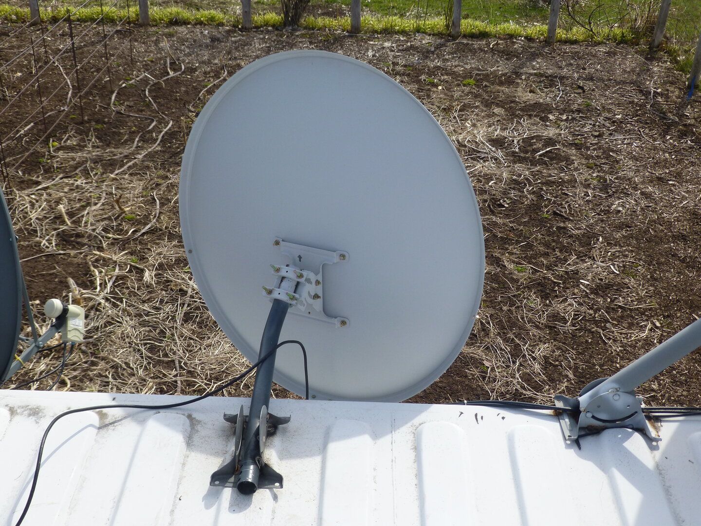

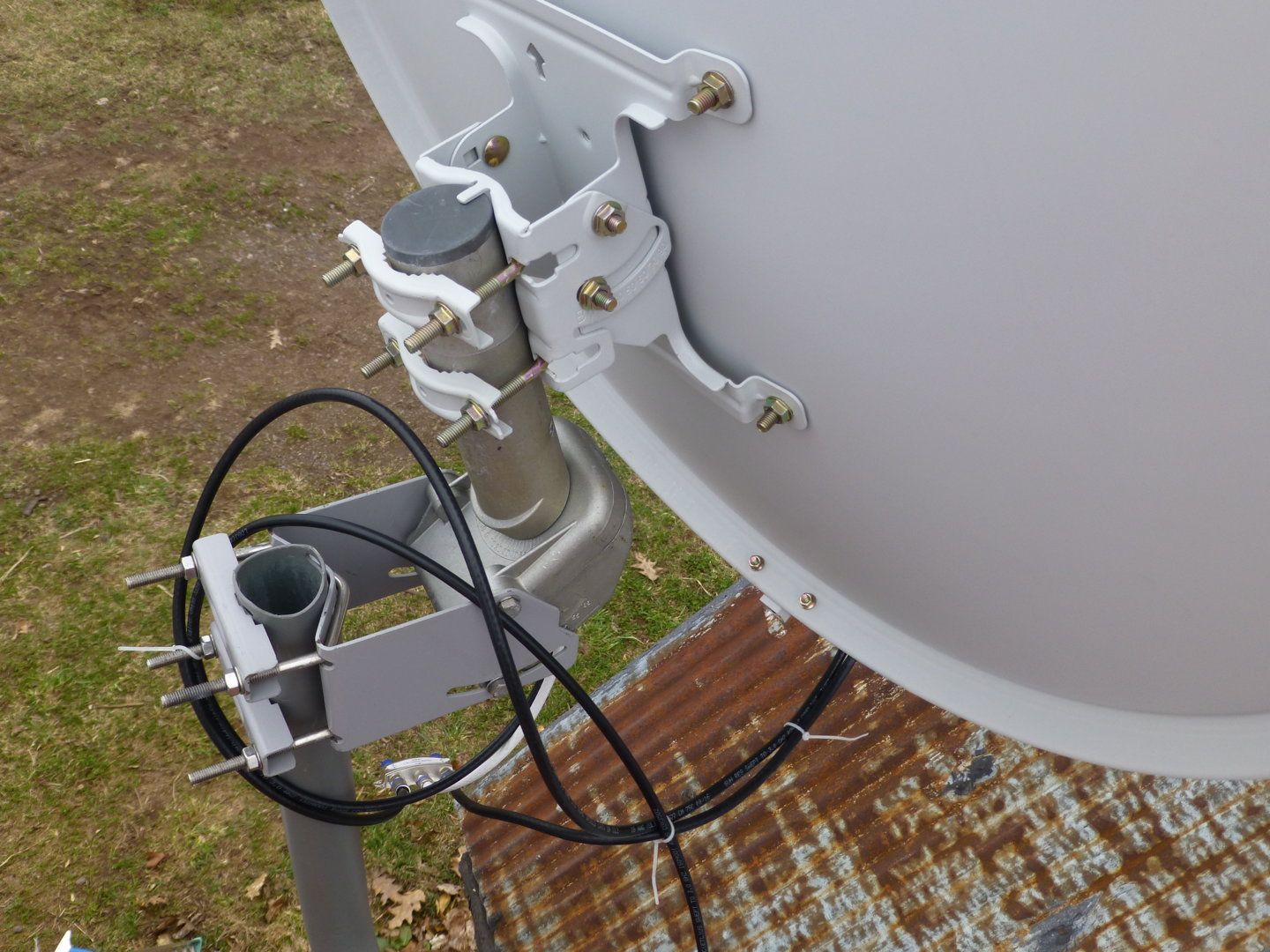

Okay, i hooked up one of my 99cm dishes today and aligned it to 34.5w. I welded the mount to the storage container and quickly found the satellite and locked the signals and dialed it in. For now, i just quickly stole a diseqc position to test it.
Tomorrow - I will hook up the multi switch so that i can feed 34.5w properly into my cable network.
I am getting good at this.... Once I am all done, ill post picture of the new dish.
I am quite happy with 34.5. It has lots of channels (Spanish) and some good radio music channels and they are all in the low band which is kinda unique on our side of the Hemisphere.

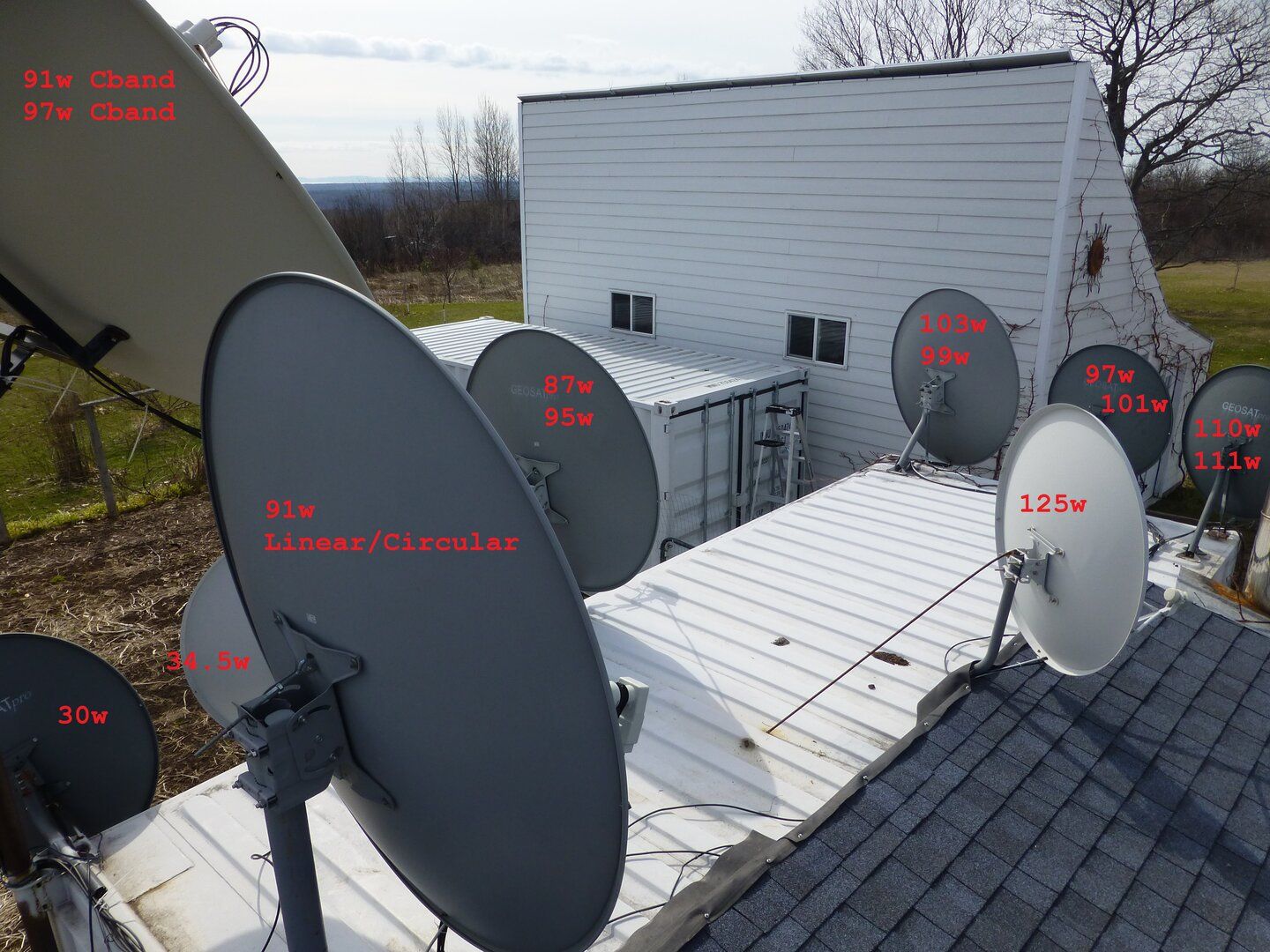

I don't know why i never did this before, but i created a new 'bouquet' and named it Fixed Arc, and added one channel from every single fixed LNBF. So, it runs through all the satellites and circular/linear lnbfs. This allows me to quickly run through and see if anything is not working.
It's 17 channels
30 KU
34.5 KU
87 KU
91 Cband
91 KU Linear
91 KU Circular
95 KU
97 Cband
97 KU
99 KU
101 KU
103 KU
110 KU Circular [Signal Lock Only] - Actual Channels Utilized via DCII STB
111 KU Linear [Signal Lock Only] - Actual Channels Utilized via DCII STB
125 CBAND
125 KU
131 CBAND
I haven't done it yet, but i am going to name the channels by the diseqc 1.0/1.1 and 22khz setting. So, something like 34.5w 3:9:OFF
