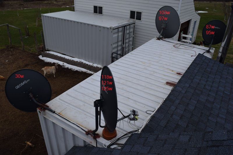

Well, I tricked out my system a bit more. One of my 5x4's had an empty lnbf 22khz tone on available because 30w 120cm dish only has one lnbf.
A year back, I purchased a 118 LNBF (11.7-12.2 circular) that i had on my 120cm USALS dish. On my 90cm for 121w / 125w , i added a 3rd LNBF to it today. So I am happy to report i am successfully grabbing 125w,121w, and 118.7w . I then plugged the dual lnbf ports to the unused slot on my 5x4 switch.
I also successfully got all four STB systems up and running.
KU Fixed System : 30w,87w,91w,97w,103w,118.7w,121w and 125w

Wow, had 40-60 mph gusts. That was a true test. Everything but 30w remained rock solid through the storm. Kinda makes sense as the 30w dish is a 1.2meter and hangs way out there. I decided to brave the 20 degree weather and check it out. Turns out all it did was rotate on the poll a little but, i twisted it back and rock solid again. We had strong north winds and it made sense that it turned it the way it did. I used my sathero 200HD to peak it. Love this little jewel.
Next summer ill tighten that and/or weld it.
Here is a picture of the dish that rotated to the right and my meter. A normal 12.7 signal was at 4db.

Instead of bolting or welding, place a few strips of non slip tread tape on the bracket then retighten. The grip tape will prevent slipping, but allow adjusting if you wish to aim at a new satellite.
Also, that is a pretty large dish hanging on a 1 5/8" J-post that is designed to be used with support legs. Would be better to weld a 2 1/2" thick wall vertical pipe on a flat plate.
Yes, i agree. It is the only dish i have on that container that doesn't have a secondary support of some kind. What is non slip tread tape? Like a teflon tape?
and this thread tape will not have an issue with the EXTREME cold we get here. Being one side is adhesive, I've come to find very few adhesives work outside when we get into the single and negative degrees.

Well, i am going to be making changes to my dish farm this summer. After 6 months, i have learned some things.
1) I am going to downgrade my 30w from 1.2m to 90cm.
2) I am going to upgrade 103w from 90cm to 1.2m (Have issues with NBC1-4 mux)
3) 118w lnb broke loose. (have to re-design holder for it)
4) I am going to land a free 6 foot solid plexiglass dish. I am thinking i can swap that for my 1.2m motorized KU so it can be my main KU dish, and then swap out my 90cm on 87w with the 1.2m , and then use the extra 90cm for 95w.
What went right. 3 lnbf's on 90cm for 118w,121w,125w is working awesome other than the (118lnb came loose from major wind storm) All signals came in strong and reliable all winter.
Does anyone have any experience with how well KU reception works on the Solid 6 foot plexiglass dishes? I would think it would perform better than the 1.2 meters?
There are a few things to consider. Fiberglass (Plexiglas) is not the reflective material, it's the mesh inside. So without knowing or seeing the quality of that it's a guess. Large prime-focus dishes provide a very narrow beam-width for KU. The larger the dish the more precise it needs to be aimed. So the flatter F/D ratio dishes work better for Ku. The better the quality of dish the better the results.
Reactions: iBoston
  • I upgraded 103w to a 1.2m and also have a side lobe lnbf pointed at 97w.
  • I moved 87w dish to a better spot on the storage container and moved the sidelobe of 91w to 95w.
  • I re-attached 118w side lobe.
  • I am currently trying to catch 30w on my 90 cm, but thus far not getting it.
I'll take new pictures once i get 30w figured out.
