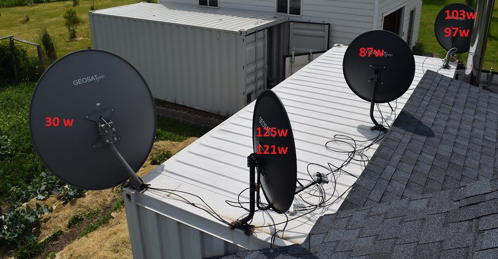

I will upload pictures in the next couple days. I had two 120 cm dishes on motors. I was tired of making adjustments and dealing with the USALS motor.
I obtained 3 additional 90cm GeoSat dishes. Today, I took down one of the 120 cm dishes. I then installed and tuned and locked in 3 dishes. two 90cm and one 120cm.
I now have the following fixed dishes :
90cm - 125w and 121w (2 dual bullet lnbf's - dish pointed at 123 with 4 degree dual lnbf)
90cm - 103w and 97w ( 2 geosat pro dual lnbfs - dish pointed at 103 with 6 degree side lobe for 97w)
90cm - 87w - GeoSat dual lnbf
120cm - 30w - Invacomm Quad lnbf
All 4 dishes and 6 bird locks are dual lnbfs and will be setup on 3 different receivers/tvs. I am awaiting a few extra parts (switches etc) to finalize.
My other existing and intact 120cm USALS dish will be for testing and scanning other birds. (Invacomm Linear/Circular lnbf)
The only hard part was setting up the 120cm at 30 west. I couldn't figure out why i couldn't hone in a signal. Turns out that the dish elevation slider doesn't allow the dish to descend down enough. I had to put a wedge in where the mount slips in so that it tilts forward a few degrees. I then had extra play on the elevation to fine tune it. I am getting excellent signal quality with many tp's at over 13db.

Nice. Are you getting reliable reception of LPBS off 87w? From my location, the LPBS is problematic on occasion with the 90cm GSP. 30w at ~9° elevation does fine on my GSP 90cm. I have a 1.6m aimed @ 87, and only rarely does the signal drop out on it.
Did you think of going with the largest dish pointing @ 87w?
The only channel I am having problems with is my 90cm pointed at 123 for 125/121. Montana PBS. I am going to to switch back to pointing at 125 and side lobe to 121 and see if that fixes me back up with Montana.
I am not having any issues with LPB on 87 at all.. However, its only been setup a few days. I am getting 10.3 db and it is the weakest signal for me on that bird.
I put the big dish for 30 west being it was the one that was going through the most atmosphere. I wanted to make sure i got everything rock solid, which i do.

What is your elevation on 30W?

12 degrees for 30w.

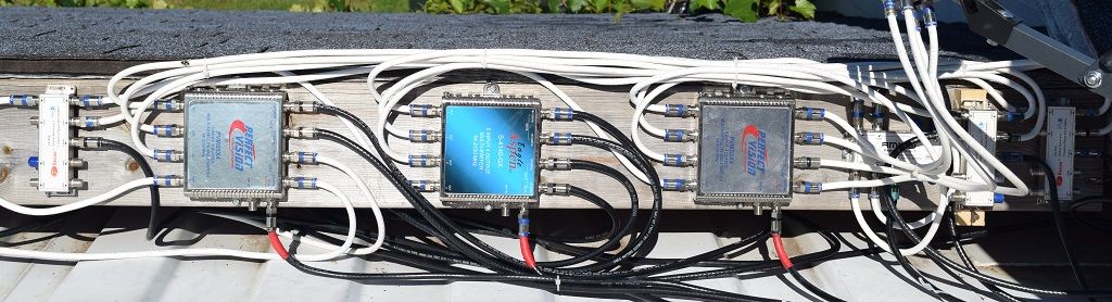

For the KU dish farm, I am running 4 8 port diseqc 1.1 switches. (one for each STB) They then run to 4 separate 5x4 POWERED multiswitches. (one for each KU satellite)
Eagle Aspen 5x4 Satellite Multiswitch S-4140-GX 54-2150 Mhz
I had previous tried the unpowered switches, and they did NOT work for me.

boston what kind of switches do you have?
I have (4x) 5x4 powered multi switches. 2 are Aspen Eagles and 2 are perfect visions. I previously tried the un-powered units. They wouldn't work. I tried two of them. Both were useless. It might have been the 100' foot run?? The powered units work great and allow me to hook up 4 STB's.
I then have 4x 1x8 diseqc 1.1 switches. One is an Amiko and the other are Gecen. Chinese switches that seem to do the trick just fine.
Example : Living Room :
Receiver goes to a diseqc 1.0 switch. Port 1 goes to Cband dish. Port 2 goes to USALS KU. Port 3 goes to Diseqc 1.1 switch. Ports 1-4 go to the 4x power multi-switches which access all the fixed KU dishes.
Model :
Eagle Aspen 5x4 S-4140-GX
Perfect Vision 5x4 PVMS5X4
Gecen GD-81E 8x1 Diseqc 1.1
Amiko D-8/1 DiSEqC 1.1 switch
