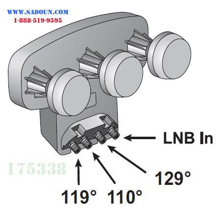

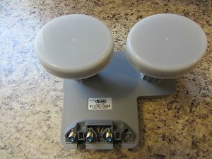

Your dish need to lock like that:
NOT like that:
or
