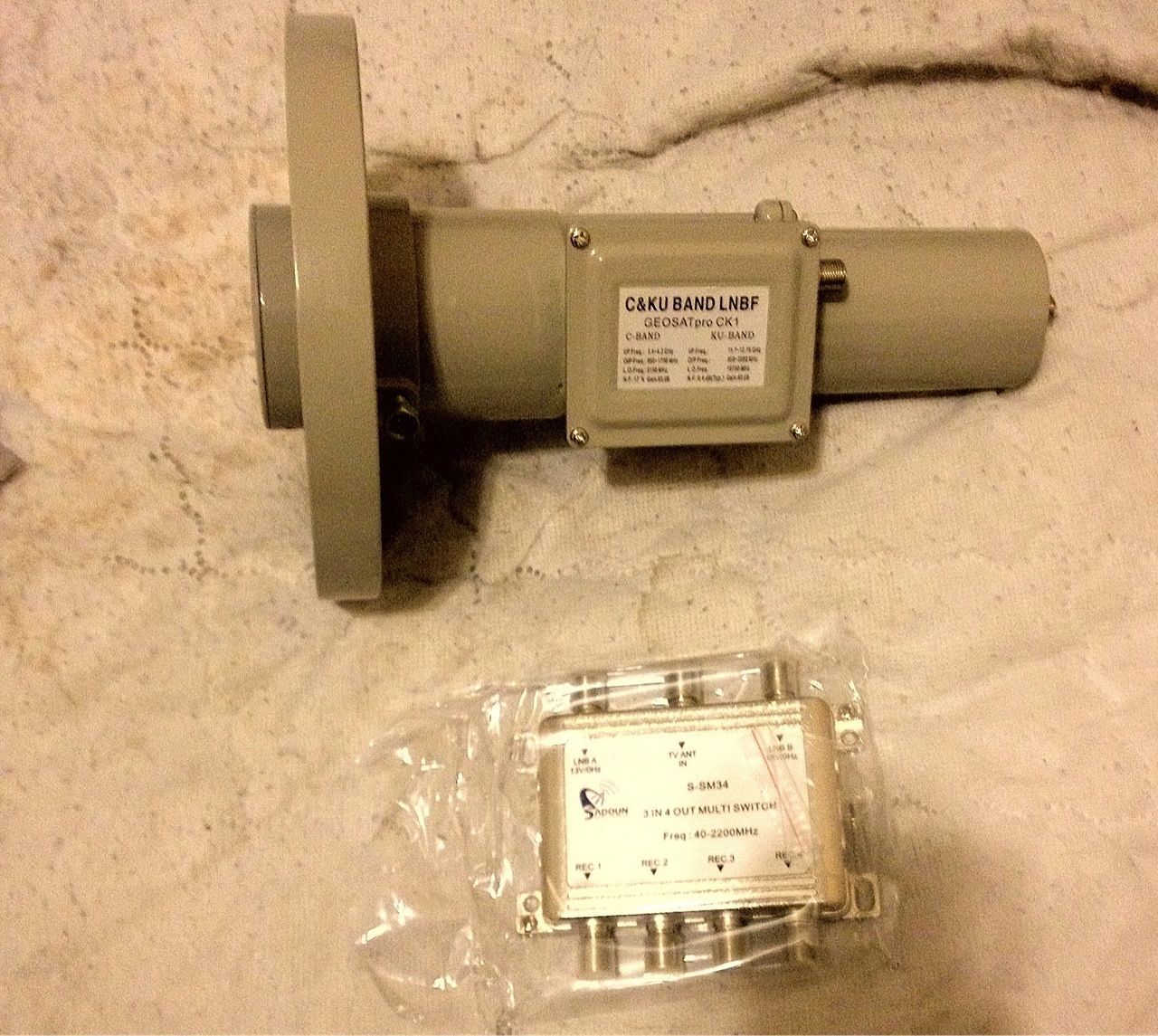

is there a way to use the C/KU lnb in the picture with the switch in the picture?

Can I use a dual c lnb with a dual ku lnb attached to the connected with 2 disquiet switches with the multiswitch for multiple receivers
A dual output C-band (ex: SatAV C2) along with dual output Ku LNBF (ex: SatAV SL2) would plug directly into an unmodified 4X4 (or preferably a self-powered) 4X8 or 5X8 multiswitch.
(recommended switch is cheaper than smaller ones)
The outputs of the multiswitch go directly to 8 receivers.
If those two LNBFs are all you want, you are done! :)
Again, see the Switches Simplified FAQ for details, wiring diagram, and programming info.

You can use a multiswitch connected to 2 dual output LNBF's. The multiswitch can connect to 1 or 4 or 8 receivers depending on model of switch. More receivers are possible. See switches simplified. BUT - before going whole hog, just run one receiver and see if it's worth going whole hog on. For the types of entertainment you mention, I think an 8 to 10 ft dish is going to be required, Something to move it across the arc also, as that's C band. Ku is mainly feeds with only 83W Ku with 24/7 retro channels. Night take a look here for information on what's on what band.
