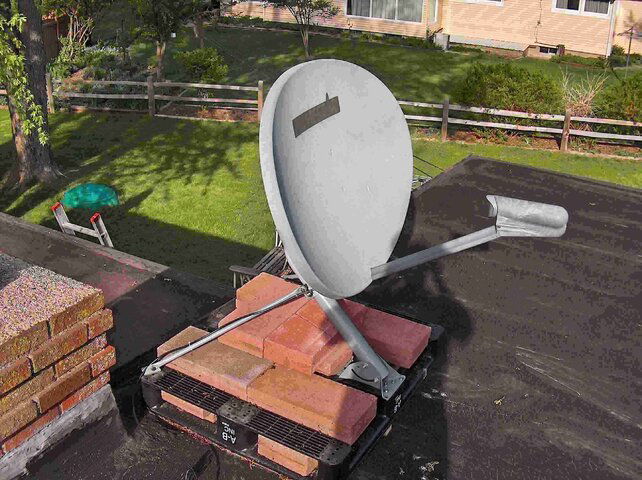

I used a plastic pallet I got free from work with some left over patio blocks I had. It has worked nicely with my Superdish mast and Primestar dish set up for G10. Mike
