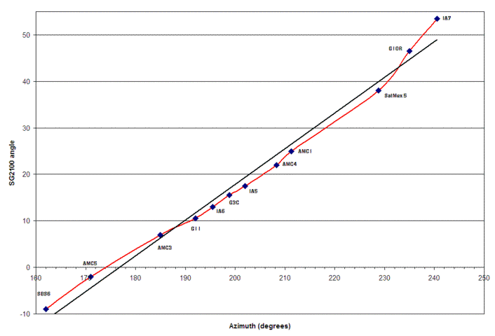

When I setup my SG2100 motor, I found that the angle markings on the motor are indeed 'approximate' - see attached image that shows the relation between the azimuth angle of the satellites I set up and the angle marking on the motor. Basically you can use the angle marking to get the dish 'in the neighborhood' when setting up your system, but that's about it.

Chris.
