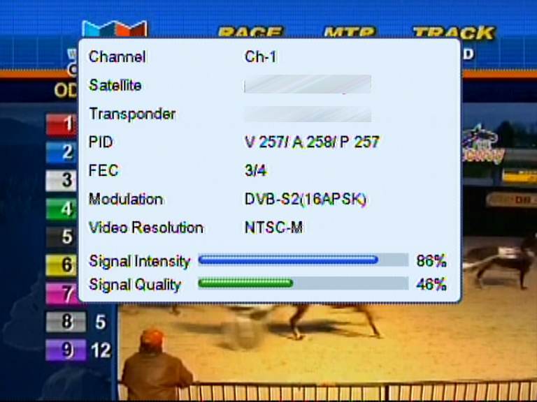

Figured it out. I came across a 16APSK video feed and the manhattan tuned it in. That tells me 16APSK is supported, but not in every DVB-S2 sub-configuration. Data transmissions are likely to have something else in the signal configuration that the Manhattan can't handle (thus why the ones I tried the other week didn't lock) but 16APSK feeds with video likely have the right kind of DVB-S2 configuration to be lockable.
I'm attaching a pic of the info screen that shows the "!6APSK" part.
Whoa-Ho that is pretty cool. Good find!
Can you post the feed you found this on?
