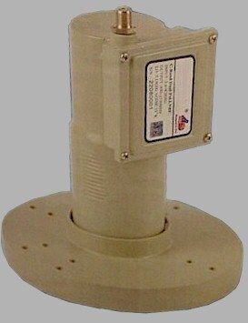

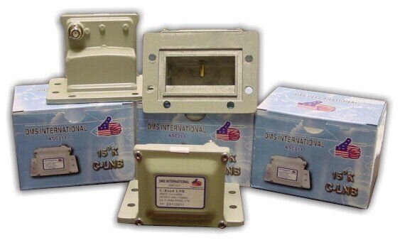

Below are the differences...the first is a LNB, the 2nd a LNBF (these are for C-Band)
