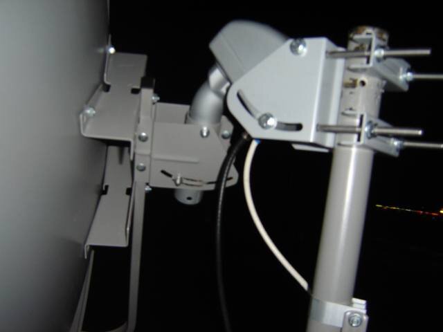

also once onto the G25 freq i adjust the motor in USER mode where it seems that on click moves a dish just a tad to the east/west.. i decided no longer to touch any screws on my dish/motor elevation since i get perfectly well 3 satellites so these settings should not be off.. not by much anyways i do not think since i am getting very nice signal for the most part so i think the dish/motor elevation are pretty well set

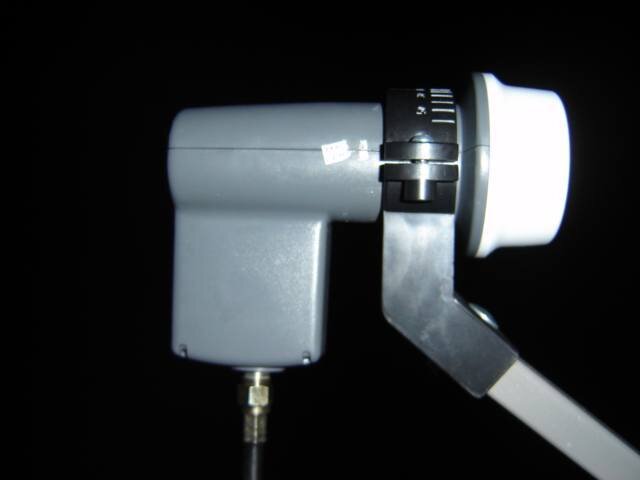

I tried moving the LNB little further/closer to the dish as it can be moved back and forth by half and inch or so.. being out further so the neck of the LNB touches the bracket seems to work best for all the satellites i pick up so far.. including the stubborn G25
the few pics LNB how it can be moved back and forth a little this way seems to be the best "back and away"

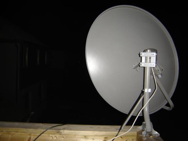

dish is now pointing on Hispasat.. you can see my neighbor's house there it's pretty much pointing almost in to it :D I have not seen him a few days maybe it fell from the sky and in his living room:clap
and one more of the mechanism.. this pole is actually plum i just made a stupid angle picture :rolleyes:

If it's possible, take a small tv and receiver out to the dish with you. Having an observer watching the TV really injects more confusion into the process. Then, just push on one side of the dish and see if you get any improvement. Then try the other side. Remember that you have to allow time for the signal to stabilize. You'll have better luck with all the components right out there with you. I found a small TV for about $10 , that works well enough for this purpose.

These dishes are offset dishes, which means that they are actually seeing a spot in the sky that is 22 degrees above where the dish appears to be aimed. That is why it appears as though the dish is pointed at your neighbor's house... It is actually seeing a signal coming from 22 degrees higher.
As for your signal problem, it is possible your dish is clamshelled (warped). Try to lay the reflector face down on a completely flat surface. If the dish rocks, or doesn't touch the flat surface all the way around, the dish is warped. This will dramatically affect signal.
