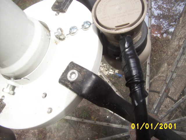

Yes I did it last year after my motor went out on my 4 ft dish. Mine is 4 degrees off from Cband. Make sure your dish it pointed at your true south location and then align your lnb from there. I get the same strenth as I had on my 4 ft dish. hope this helps

For me it's shooting 6 degrees east of C-Band. I put the lnbf on the left of the scalar.
I have a button hook feed with a base mounting plate.
Shooting dead nuts at the center of the dish gave poor signal strength vs bouncing off it a bit right of the plate.

I did my first incarnation as a prime focus Ku with a Cband sidecar on my 7.5' Unimesh. My thinking was that the Cband was more forgiving and I could focus on Ku reception. It worked great.
Then I moved to a bigger dish - 10' KTI and a C/Ku corotor. My Ku reception is at least as good or better than on my 4' offset.

Pssst. I was in your boat. I held the lnb in my hand until I snagged a signal.
Make sure the polarity index always matches the one on the c band feed.
Tune your dish spot-on to a c band tp. Then tune to a strong ku tp on the same sat.
See if moving it around snags any sort of signal. That will give you an idea if you're in the ballpark.
Look at post #8 if you haven't. I could not get any usable signal on the same sat the dish was aimed at.
I tuned the receiver to the next ku/tp on a sat to the east (dish stays where its at).
Moved the lnb until I found a signal. As it is because you cannot get the lnb direct in line of the c band feed throat.
You will receive a signal a bit east (if you use my pic for an example) of the c band sat it's aimed at.
Yes. Get the lnbf as close to the scalar as you can. My bracket wouldn't let me.
The focal length will be close. But don't assume anything at all. It's not a hard job if you think of the reflection angle you're working with. It took probably 10 minutes for me to grab a signal after scratching my ass a few times.
Another little bit bending up a piece of aluminum and drilling the scalar for stainless steel hardware
When you position the dish at its highest arc the ku lnbf should be perfectly in line left and right to the c band feed.
Not higher or lower.
