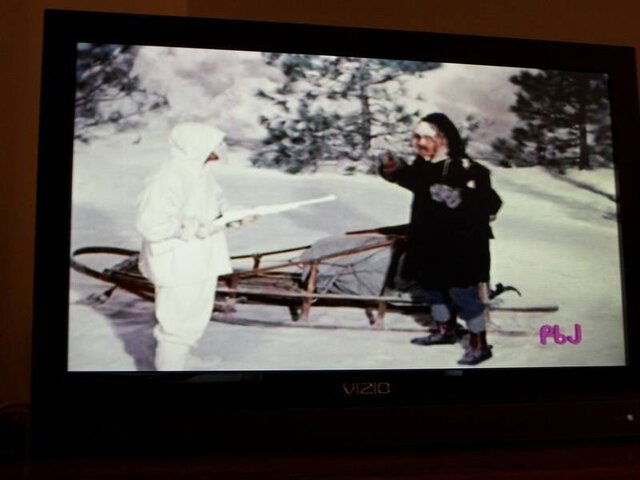

Well the Skybox S12 didn't arrive DOA, so I'm happy. I blind scanned in 107 channels from SES 2 C-band with no problems. The receiver was kept on for several hours with no signs of over heating.
I like the size, because it fits well next to the TV in our bedroom.

Try it on PBJ on 83W Ku and then the Ion mux on 103 C. Let it run on those channels for a few and see if it locks up.
