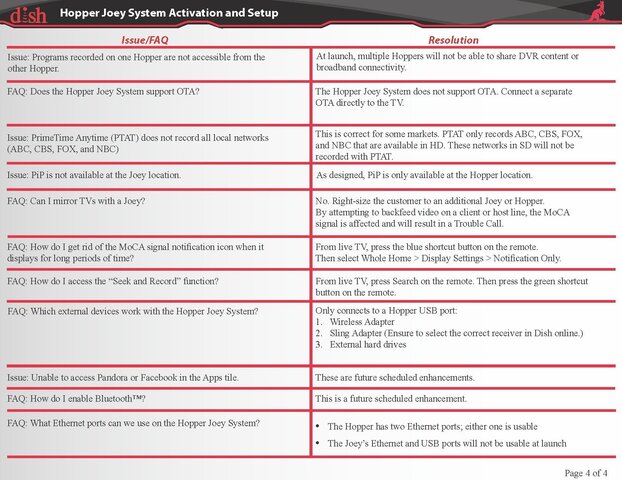

Hmmm... According to Dish the Ethernet port on the Joey is not active as of now.... Did you try hard resetting both the Joey and Hopper?
