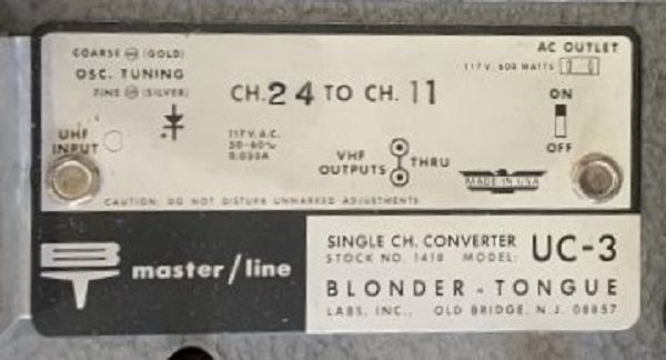

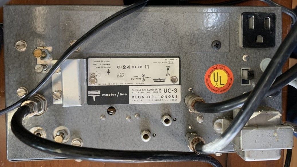

also If you look at the gray box in the pictures at the top of the thread, that says ch 24 to 11. single-channel converter. It has a uhf input and vhf output. Is this a converter when uhf tv was new and TVs didn't have a UHF tuner ?
Yes
in the second VHF port it seems to have a channel filter, guessing by the model number it is for rf channels 1-12
There are two VHF ports for VHF feed thru. This allows you to add CH11 to the existing VHF line. The tuning controls optimize the conversion of 24 to 11. If you mess with the tuning, you will need lab-grade equipment to retune it.
