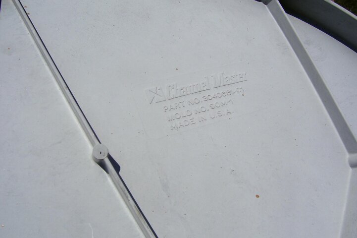

Hi folks,
I've just acquired a very nice Channel Master 90M-1 (36"x39"). It's missing a few
original parts, but I think I can adapt.
I was hoping to mount my Invacom QPH-031 to it's focal point.
Is anyone else using this type of setup to pull in the LPBS stations
on 125W, AMC-21/Ku?, or should I hold out for a larger dish?
Thanks.

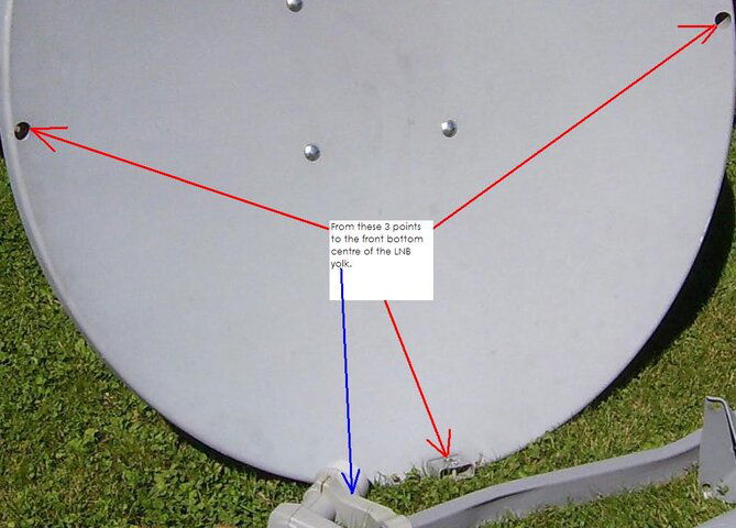

If anyone has the same dish (90M-1), would it be much trouble to take some
measurements for me? Please see attached pic. With those numbers, I'll have
a good place to start.
I've got some old aluminum tent poles lying around, they should do nicely for
the side supports. Since I don't have the original feed-mount, the trickiest part
will be truing up the LNB to the focal point.
Thanks in advance for your help.
Hi again,
After a bit more online searching, I found some images of this dish.
Turns out that the only thing missing is the original LNB.
The Andrew/Channel Master CM90 was built with a rectangular feed arm,
and had no side supports.
I swiped the Invacom QPH-031 form my idle setup, and gave it a whirl on the CM90.
