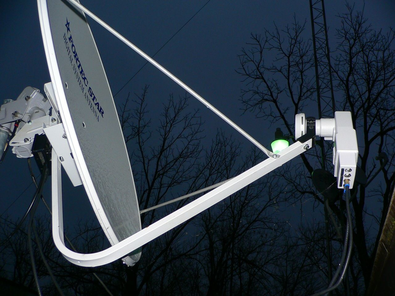

I have run a 33" dish with the qph-031 and Stab 90 motor for over a year with any problems.
I think the 031 is highly over rated in terms of performance. I replaced it with a regular linear lnb without any noticable loss of performance. I just didn't like all the extra weight on the end of the lnb arm also did not need the circular option.
Perhaps during the install of the 031 something was disturbed. I would closely inspect all the cable connectors.
not over rated but over weight :D
imo
still the best i've seen. newer one's have caught up a lot. but on a weaker feed it still shows it's colors. when it first came out was miles ahead. and long service most of mine are 5+ years old.
have had them on 36 in dishes w/Stab 100 motors for 5+ years.
I have one that I got from Craigslist last year for $10 and havent even used it much as it adds weight to my 1.2m arms and personally makes my dish look UGLY :eek:
Sent from my X2 Premium HD with Tapatalk 2
My only problem with the QPH-031 has been that the feedhorn cover deteriorates easily due to UV.
As for weight, a dish with side mounted struts is necessary.
been working great all these years without them.the arm pretty ridged being one piece from back to front unlike most others that are placed on the bottom with one screw.imo
falling under ...if it ain't broken rule here
