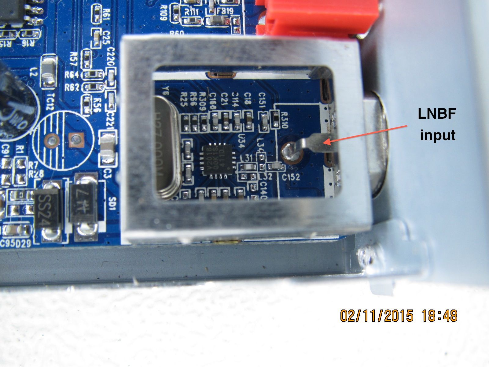

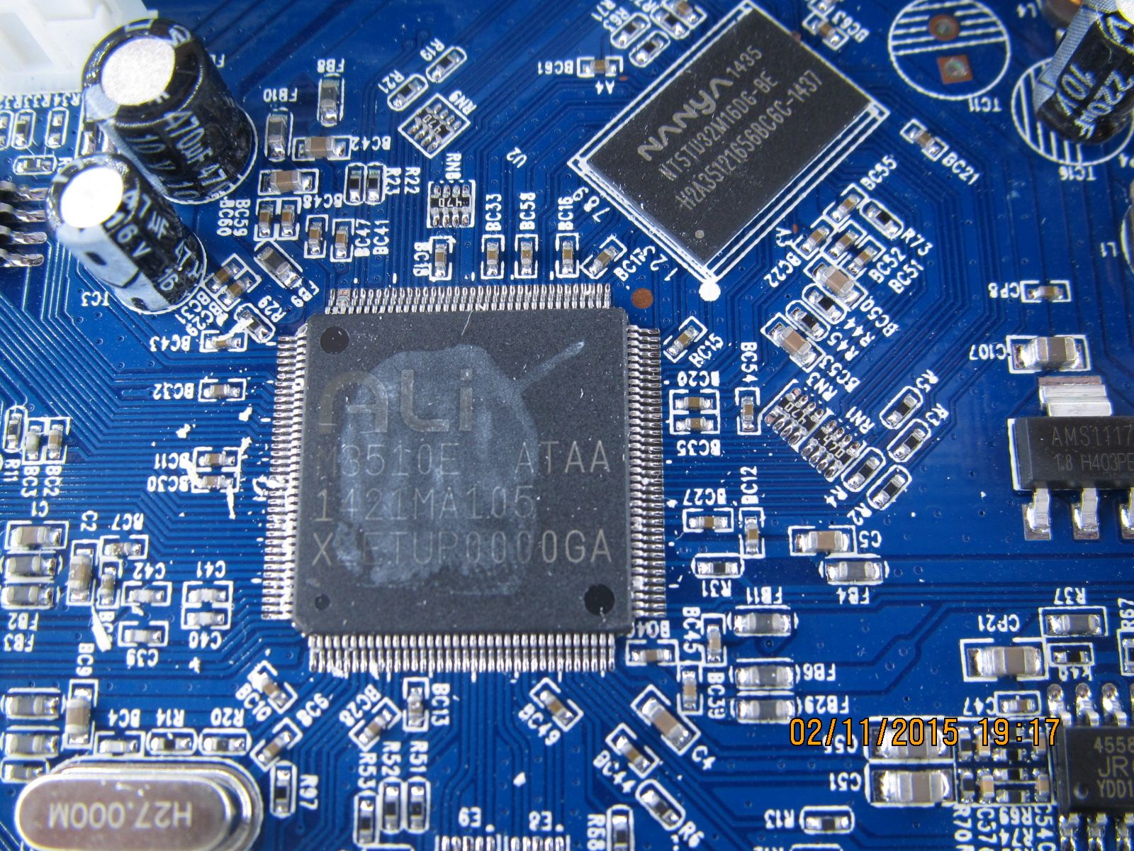

I tested a similar receiver last year and it has the msd-7816 configuration. Similar menu screens and the performance was similar to the openbox s9 or s10.

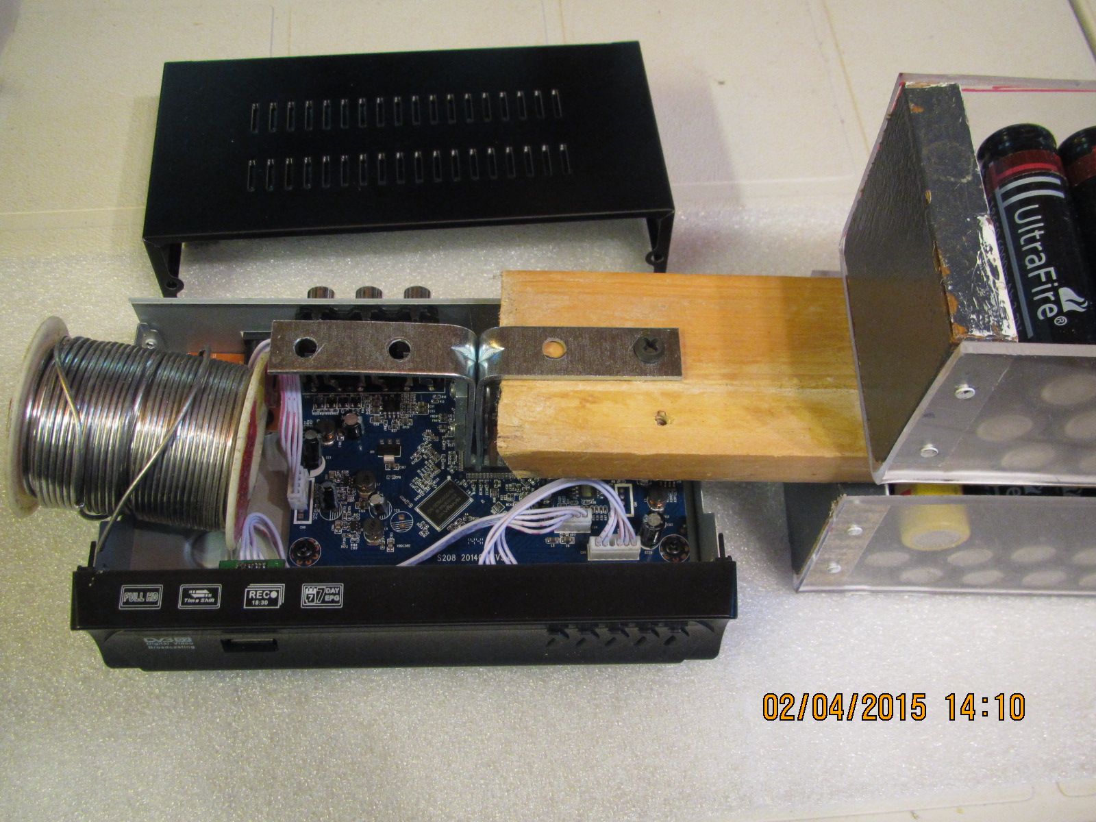

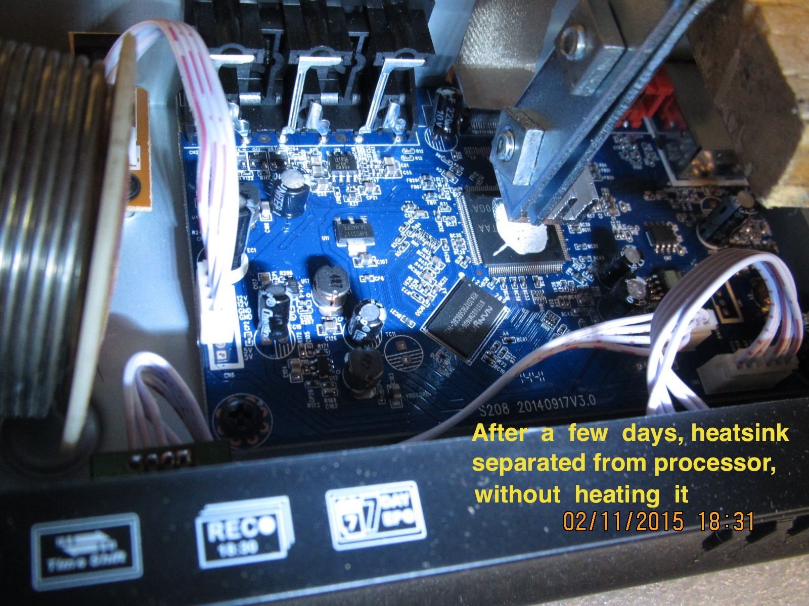

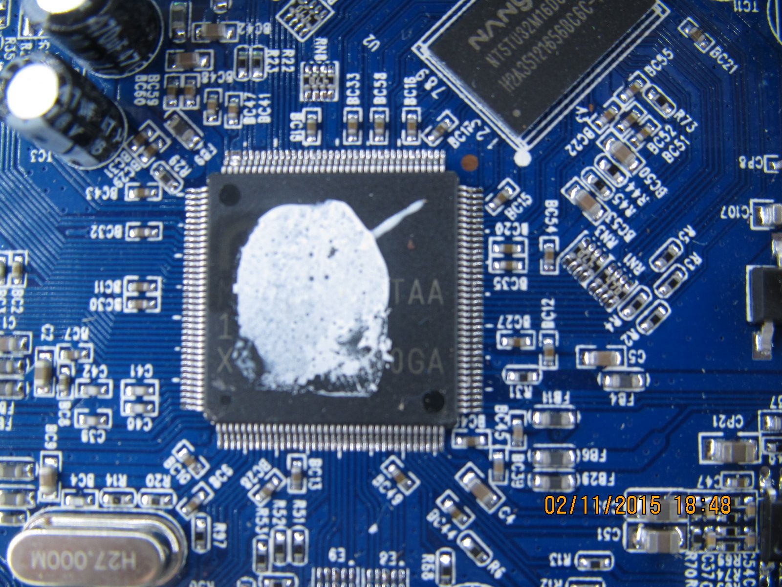

If you are really curious about the chipset and tuner, the fins could be heated and removed

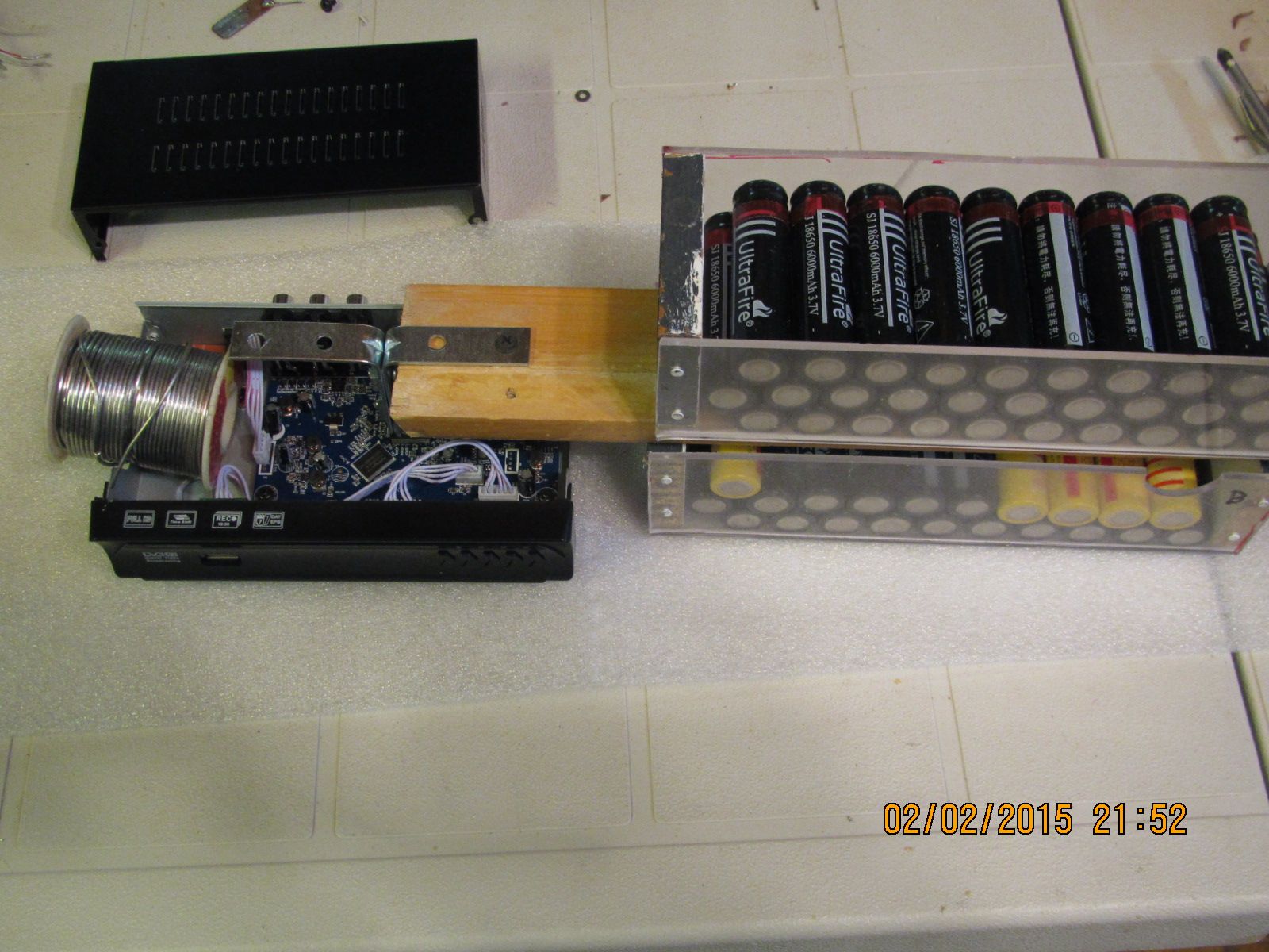

I am curious (as usual), but tried to avoid applying heat. Was hoping that twisting torque would do the job, but to no avail.
Just pinched the edge fin with metal angles and hung it above sponge, 1/4 " high. For more torque, loaded the rec's edge with spool of tin.

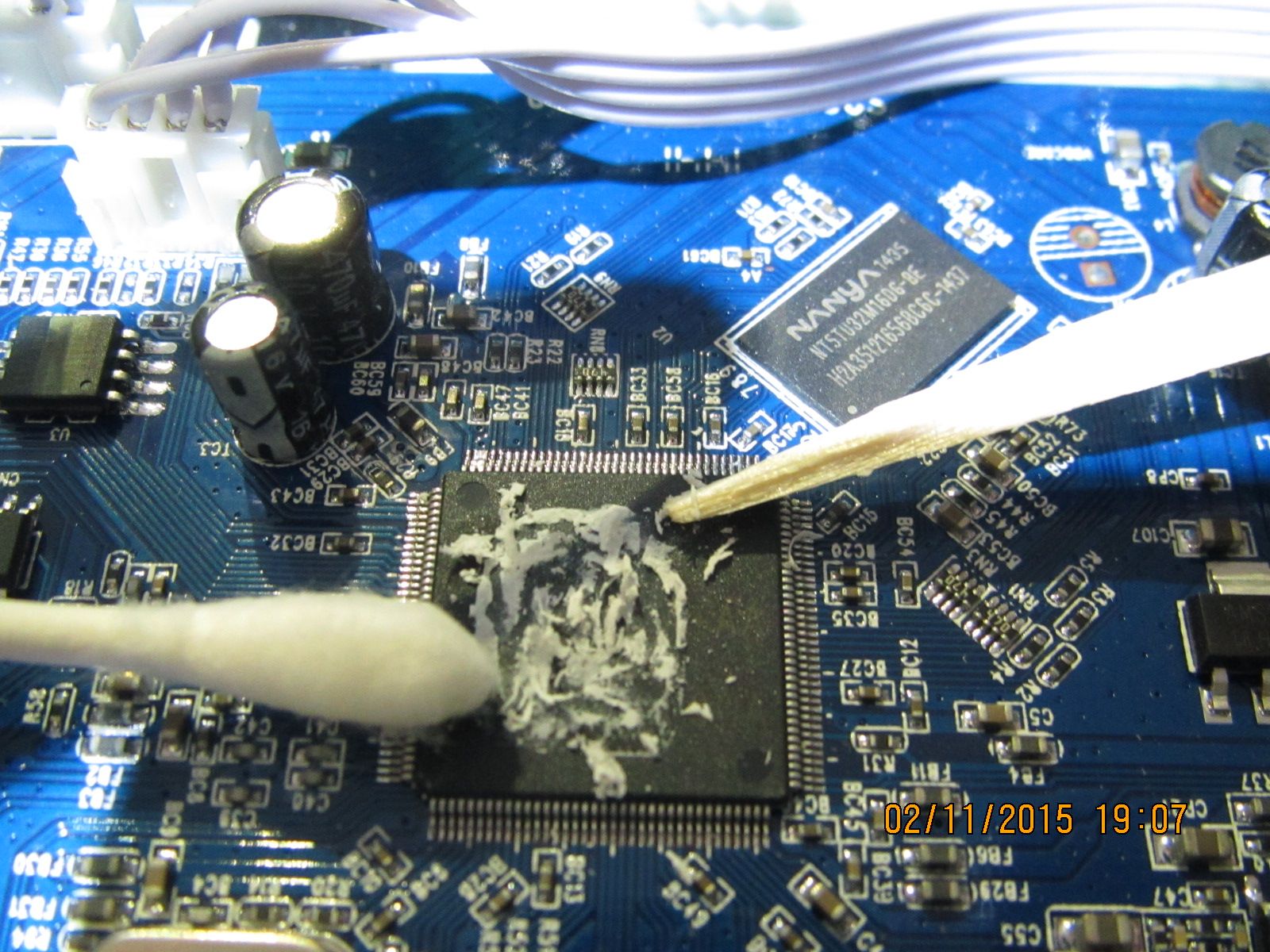

After 3 days, considering applying heat, but how? Soldering gun ? Or, just plugging in its 12 V power supply? In this case, I would have to sit and watch, because without heatsink, the chip can get cooked...

What glue can be used to fasten the heatsink to processor?
I also plan to paint the fins black, just in case...
Something similar to this:
Amazon product ASIN B0009IQ1BU
Look around and see what the video overclockers recommend. I think those guys also use little aftermarket vga chip heatsinks with 12v fans if you want to upgrade your cooling.
