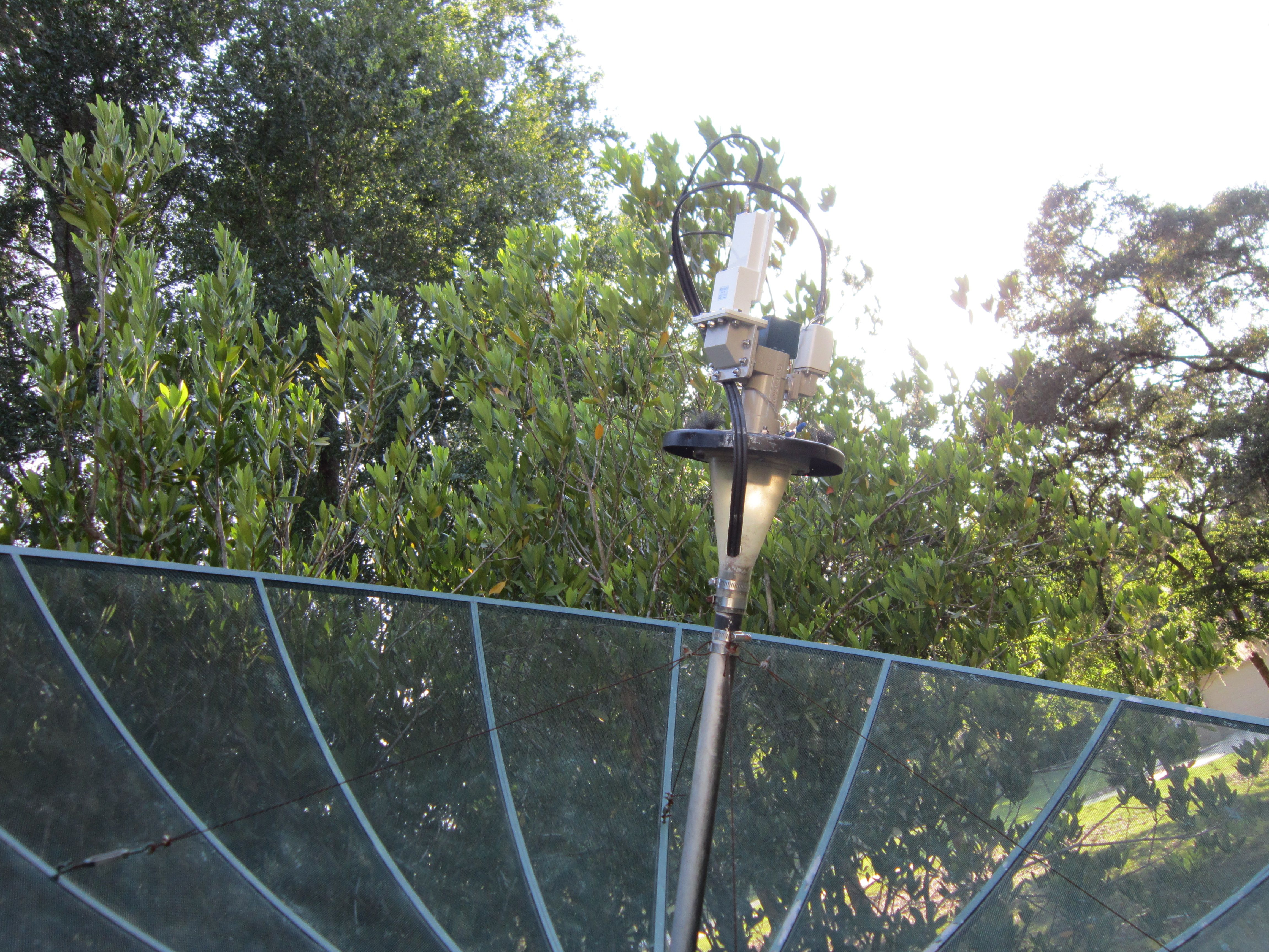

Took two pictures. The picture of the lnb is worthless IMHO
as it is set from my attempts at getting a signal at 55 degrees.

Change the dish elevation to 58 degrees? I don't understand why you change the elevation setting if the dish has been tracking the arc for many years?
Please return the dish elevation setting back to previous setting.
Is the feedhorn skew (LNB twist) returned to the original setting that worked on July 1?

Take a picture with the inclinometer on the dish. If you didn't change the elevation on the dish to get the inclinometer to read 58°, what did you move?
The motor like I asked above?
