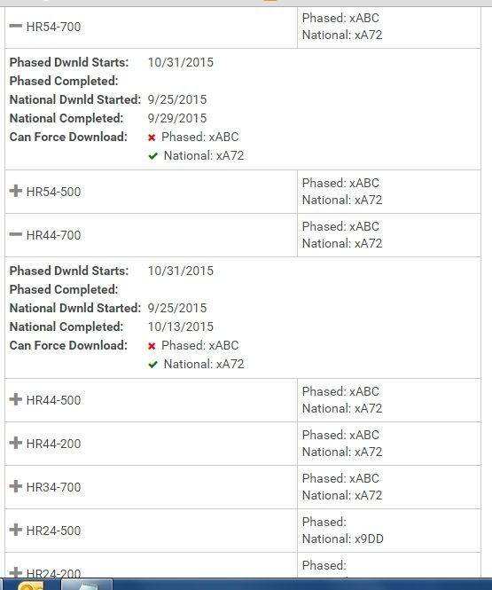

Wow, ... very interesting;
Very good find Scott...
Wonder what specific software download that is which will enable the R-band signal strength screens to appear on the Genie?
So far only seeing the new LNB listings in the sat. setup of the HR24s here, but no 99/103cr screens
And I notice that while the document states that both 99cr and 103cr screens will appear, only 99cr is pictured. I notice because the rights to the R-band at 103W was still in legal dispute with other entities last I heard.

I don't think you ever going to see the readings on the HR24s. The R band is supposedly only for the HR54s.... Or so I think....
Selected the "Slimline-5DR" option in the satellite setup on one of the HR24s as a test and the 99 (cr) and 103 (cr) screens appeared. All zeros of course off my SL-5/SWiM-16 install here.
Sent from my SGH-M819N using Tapatalk
