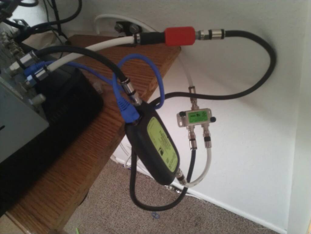

So,
I found today that to hook up a receiver DECA to a hr20, you have to (from LNB) 2 way, BS filter to SWM port, then receiver DECA for power to Sat port 2. Then Ethernet from DECA in top port. Without theBS filter the signal gets all pixelated...any one else know of this?
Yup, I just swap them out unless a customer is dead set on keeping the receiver for the OTA or recordings
Posted Via The SatelliteGuys Reader App!
