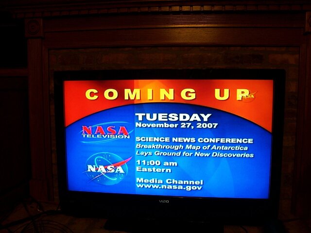

After doing some adjusting on my BUD, I blind scanned AMC 7 and could not believe how great the picture was on the NASA channels.
Not bad for a SD signal on an LCD HDTV!
Here's a pic I took earlier today.

way off topic
This myth that SD doesn't look good on LCDs may or may not have ever been true.
I have a Syntax 542i which I got last Xmas, and after adjusting it to the SD sources, it's spectacular.
50% of the problem is that you can now see how bad FTA/Dish and some local analog channels really look. - :eek:
And of course, when you compare to dazzling digital local HD.... well, any SD pales by comparison.
On my 27" RCA analog set, everything looked uniform, with all the rough edges smeared off.
I couldn't tell Dish locals from a DVD, so I thought they were the same. :)
A proper calibration of the set really does help with the SD, though.
...and it did look a bit drab, right out of the box.
So, I'd say that today, anyone who still believes the myth, needs to look into the cause and solution.
There's plenty of sparkle in those LCD TVs. :cool:
I'd buy another without a second thought.
