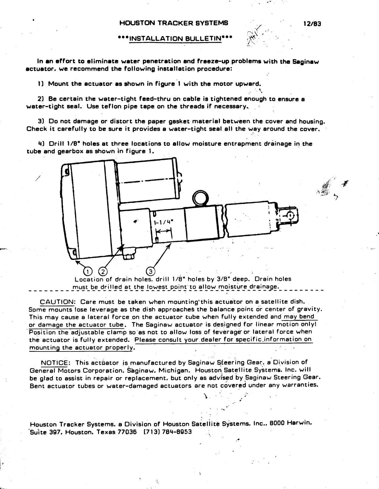

i have a HTS receiver and manual I received when I picked up my ten ft dish. I dont know whether it is a HTS 4 or not. It says it is a System 70?
would this help?
