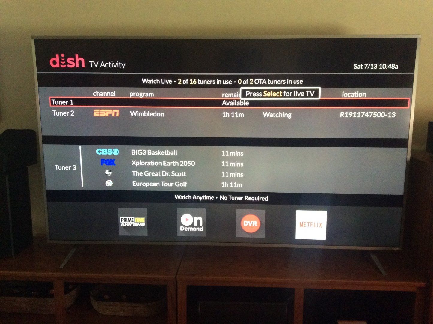

I have always had that prime time turned off in my HWS and have all three tuners available, and i never had the problems with this being off that the Dish rep alluded to. Give my suggestion of getting a UPS a try, I think it just might solve your problems.
As for what Bobby said about the tuner 3 showing ,I have to disagree. I've never seen Tuner 3 showing all the Main Networks if no TV was tuned to one of the those channels. I've only seen it say Available, if no Network Channel was tuned to. I'm not saying it can't happen, just that I've never seen it

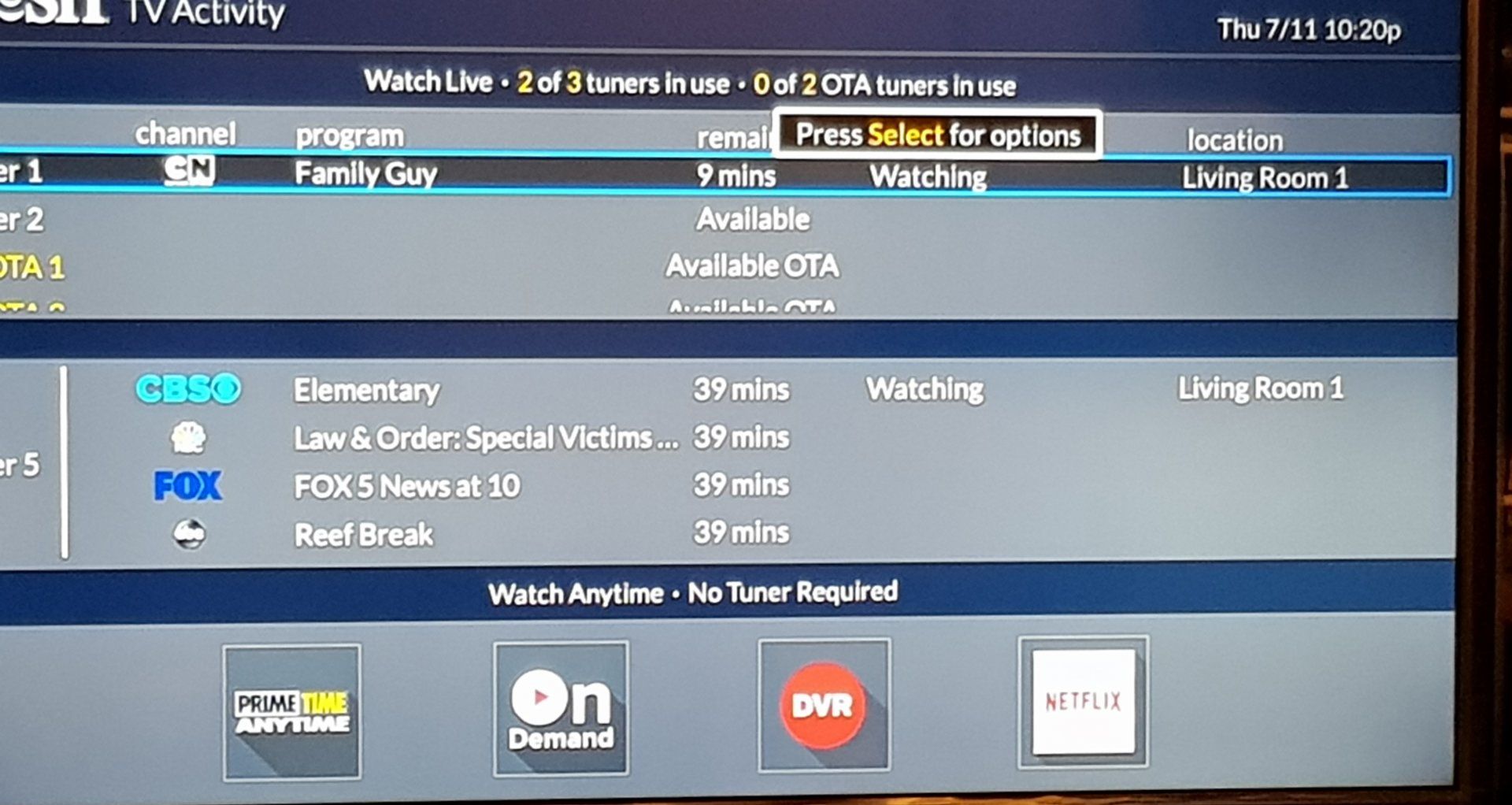

I don't know why yours is doing that, but this is mine taken just now:
I'm curious, when it says "watching," where does it say watching from? There is a location immediately to the right of where it says watching. Could it be that one of your Joeys is not in standby and was watching one of network channels? Just because the TV is off doesn't necessarily mean that the Joey is also turned off. When you might see that again and it shows watching from a Joey location, go to that location and see if the green power light is still on. There will be a 5 minute time after powering down with the 54 remote that the Joey, or Hopper, will remain on. After that 5 minute period the Receiver will go into standby.
It says watching from Living Room 1. Tuner 1 says the same. We were actually watching Tuner 1. No one was watching CBS. The TV with the Joey was turned off several hours prior. There was no recording going on, no timer scheduled, DVR empty, only the green light was lit on the Hopper (not the red DVR light), and PTAT was off.

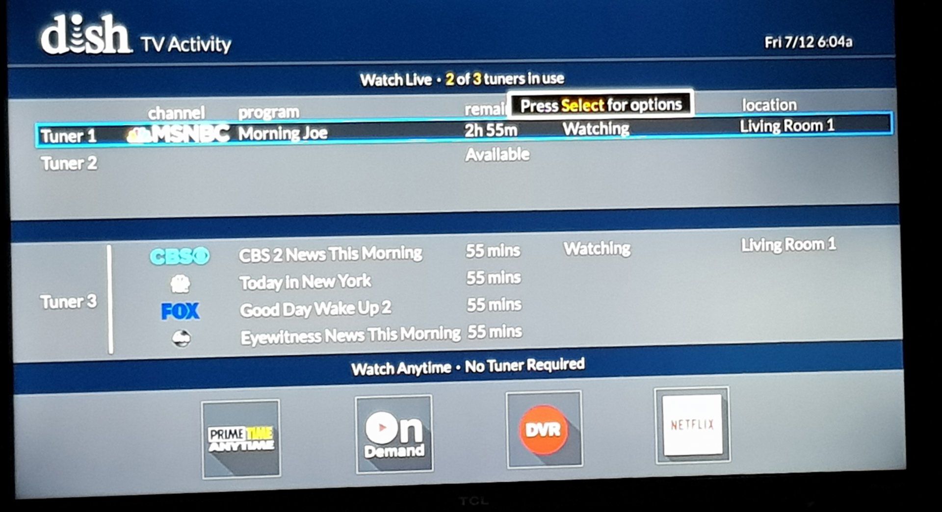

The next morning, same thing. Tuner 3 and Tuner 1 both watched, simultaneously, by Living Room 1. We were actually watching Tuner 1. No one was watching CBS, there was no recording, PTAT off, the Joey TV was turned off, etc.

Thanks for your last photos. I see an issue in that the photo shows that your Living Room 1 TV is watching two things at the same time. Somehow something isn't happening when you change channels. I don't see how that can happen unless something is going on with the hybrid arena. Your hub has been changed, your Hopper has been changed. If I were them I'd change the LNB. That's the last of the hybrid equipment.
Using picture in picture or a channel on swap might show two things at once.

I was thinking the same thing as JSheridan except that my Hopper3 will say "Watching PIP" under status when multiple tuners are being used.
We should keep in mind that a Hopper with Sling may act differently than a Hopper3.
Right. It almost looks like PIP is on.

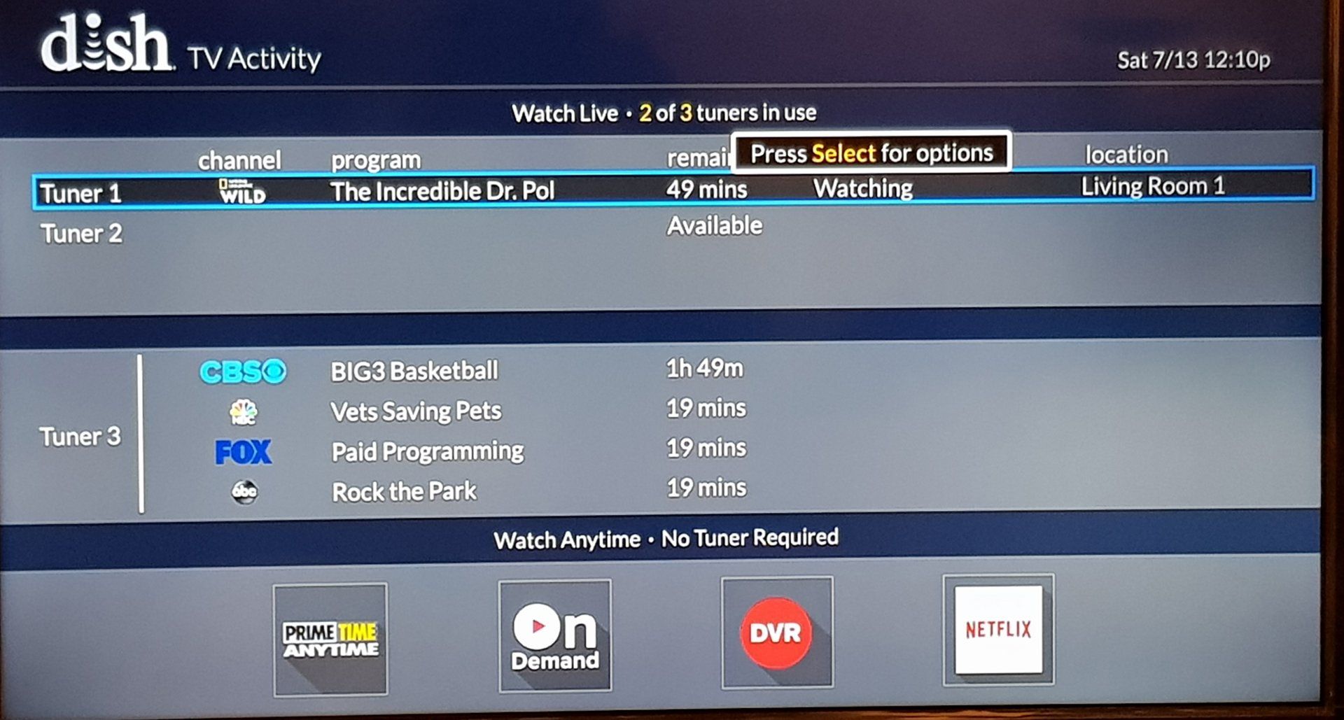

It's NOT working, though. Not at 100% like it should be. Seems like the immediate problem may be fixed, possibly only temporarily, but you should not be forced to keep PTAT on to patch an issue that never should have existed in the first place and only having 2 of 3 tuners available isn't right, either.
falconress I'm curious. I missed how many TV's you have, but if you have 3, can you try to put all 3 on non-Network channels and see what happens? Or if you have 2, can you do the same with Dish Anywhere as the 3rd TV? And just for extra merit, get DA going before you power up the Joey. I just wonder if he'll get black screen, TV Activity screen or will it clear the Tuner 3 always showing the 4 Networks
