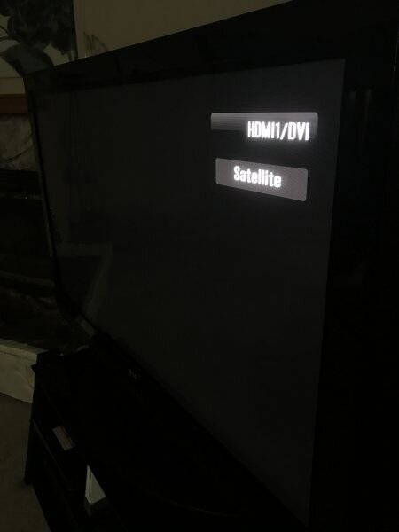

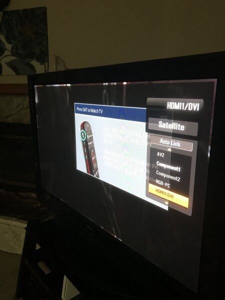

The first picture is of the TV when I first turn it on. It's on the correct input but the screen says "No Signal" and it'll stay like that forever. The second picture is of the screen after I go through all the inputs on the TV and get back to the HDMI input.

I venture a guess and say it's an LG TV, based on the display of the Channel Input menu. It also looks like the HDMI 1 input is shared with a DVI input. It may be your main input, but you may have better luck switching your Hopper 3 to HDMI 2 or HDMI 3 and switching that displaced device to HDMI 1/DVI.
