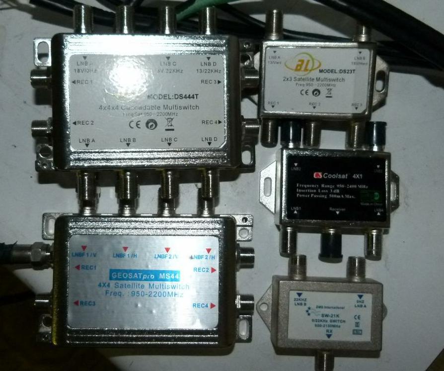

I don't (never had one) have a signature OR a Coolsat receiver, so I'm not sure what you are looking at. Yes, it matters which switch ports are hooked to H or V lnbs if you are using a multi-switch, Horizontal lnb's go to H (18v) and Vertical lnb's go to V (13v). It matters for a Diseqc switch in that you need to know which port numbers go to what lnb, so you can set your receiver correctly.

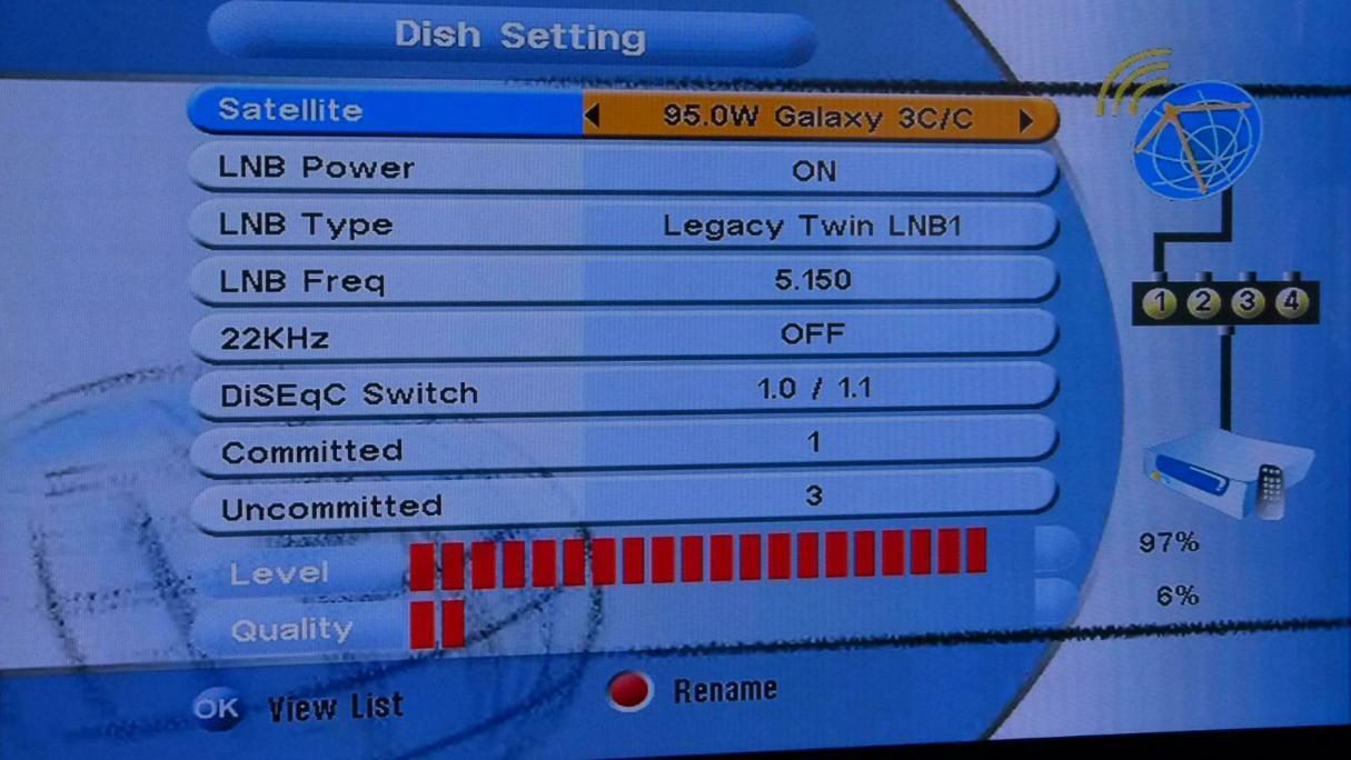

for the Coolsat 6000 this has to be set for each satellite
LNB Power: On
LNB Type: Single
LNB Freq: 5150 (for c band ), (for Ku 10750)
22HZ: off (c band) on (Ku) depending on the switch in the BSC621 for ku or c band
DiSEqC Switch = Off / None
Commited: 1,2,3 or 4 ( the setting above should grey these out not used when set to off or none)
Uncommitted: 1,2,3 or 4 (same as above)
Diseqc motor setting is 1.2 (using a c band actuator)

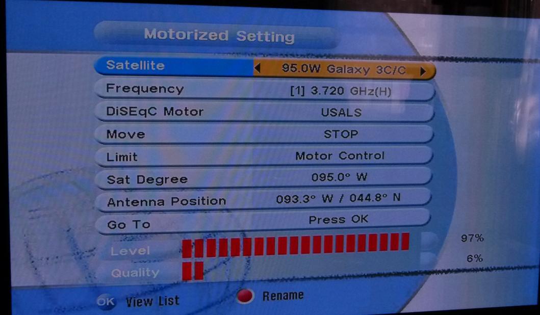

Here is a snapshot of the Coolsat 6000 Dish mover menu settings:
The first setting is the Satellite tab and in the photo it is set to 95.0W Galaxy 3C/C. I bought this coolsat 6000 off ebay used so the previous user must have programmed the satellites into the receiver. I do not know if the satellite list in my coolsat 6000 is up to date or correct but another user gabshere said in another post he would try to find a satellite list to program to my box. I'm a computer guy by profession and was also provided with a serial cable to connect the receiver to the computer for programming and have already downloaded the coolsat 6000 flash tool.
In the DiSEqC Motor setting I can select USALS or 1.2. THe next setting is the Move tab where I can move the dish east or west. The problem I have is when I attempt to move the dish to any satellite (fine tuning) using the move tab I could not get the signal Quality meter to go above 10% to 12%. It is possible my craigslist installer aimed the dish wrong or I messed it up but when I reposition the dish to my sothern satellite (91.0 West) I still get only get 10 to 12% on the quality meter but when I do a blindscan it picks up transponders/channels with 90+ percent signal. Maybe the signal/Quality meter is bad on my Coolsat 6000? In the satelliteguys.us receiver download section there is a third party update firmware for the coolsat 6000 receiver. Maybe I will give this firmware a shot to see if it fixes my quality signal meter... Then If can move the dish via the V-box and then save the satellite position if I understand correctly. I'm also going to apply gabshere's recommended receiver settings and give that a shot.

Yes. You have to manually, with either the mover remote or the FTA box E-W commands(See below), find and store each and every satellite.
The V or G boxes only understand Diseqc 1.2. USALS is for a Ku dish motor.

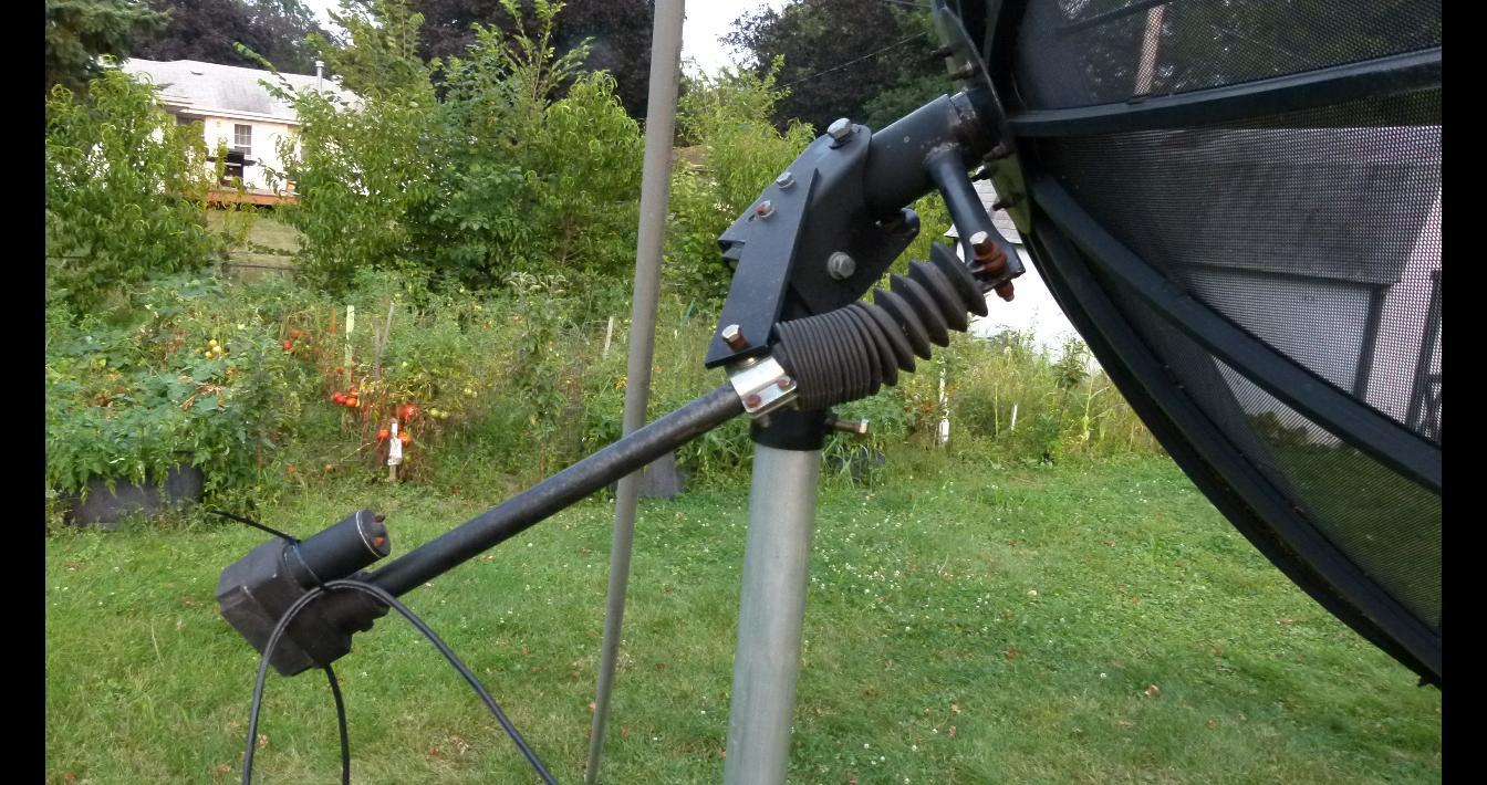

Here is a photo from the installation guide for my MOTECK-H180-Motor that is mounted on my 6ft Sadoun Fortec dish. The setting for the declination angle is 6.8 which is marked on the mount.
The next photo is of my 7.5ft black mesh mount and it has some rust and the black paint is worn off and I cannot see any declination degree angle numbers.
Do you have any idea of the make/model of the mount and how to correctly set the declination?
Thanks again....
The polar axis angle should be very close to your latitude in degrees from horizontal. Horizontal being 0 degrees. Straight up being 90.
Don't factor the declination angle unless measuring the dish angles.
Polar axis angle is latitude.
If your horizontal reading of the polar axis is 90 subtract latitude. 90- 44.8 = 44.2
