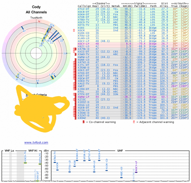

I recently cut the cord on my satellite and I am wondering which antenna would work best for me. Here is what tv fool gives me. Also is it possible to pickup some of the gray channels ? If not no biggie. Any help would be appreciated.

It shouldn't require a whole lot of antenna to pick up all of the channels marked with LOS. Going forward you'll have two VHF-high channels (RF7 and RF9) so you probably don't want to cut yourself off at the knees by using a UHF-only antenna. I'd guess that as long as you don't have designs on burying your antenna in an attic or basement, pretty much any 30-50 mile antenna would do for a household. For a single TV, an indoor antenna (that supports RF7) may work fine.
Something along the lines of the Channel Master CM-3010HD (~$20) is what I'd be looking at.
If you can't live without KBZC, you'll need to go through some hoops otherwise all the other towers are within 5 degrees of each other.

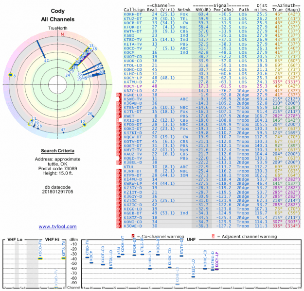

This is the other one it appears if i use cs vs county street i get different results
so which one should i beileve? Also antenna will be on outside how high should i go?

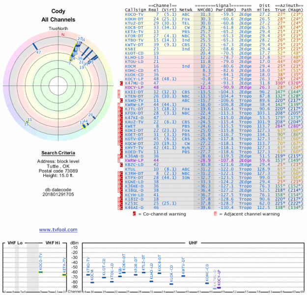

You REALLY NEED TO DETERMINE WHICH IS CORRECT FOR YOUR ADDRESS, LOS and 2 edge are 2 really different results, different antennas will be needed for 2 edge. Line of Sight could basically get away with rabbit ears.
Ok I put coordinates in instead of address a majority are LOS. I have an indoor antenna but struggle on pulling in the high vhf stations.
