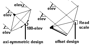

Depends on the dish type, give us your zip code and we can give you the exact angles to the satellite!
An offset dish seems to be looking lower than where it actually is. (See below)
