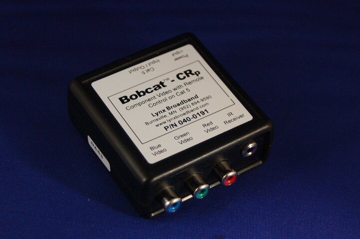

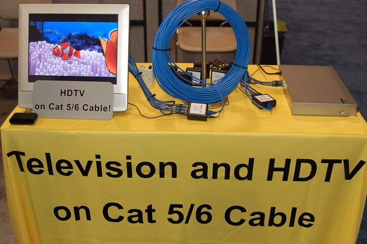

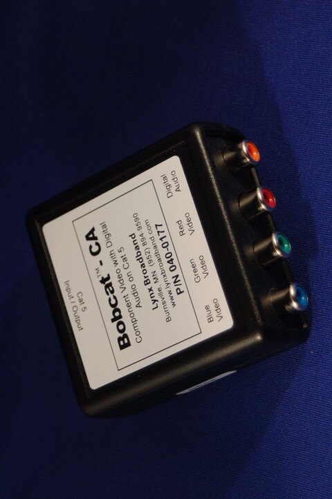

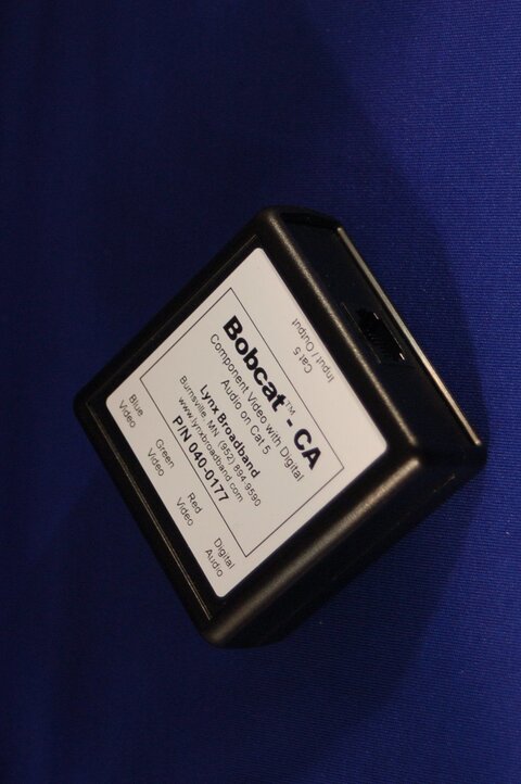

Here is a great way for you to get HDTV in a place where you dont want lots of wires or even satellite receivers.
Imagine taking your HD receiver (or even non HD receiver) and putting it somewhere, now you just need to run one wire to your TV, and that is a cat 5 or 6 network cable. Well the future is now.
Introducing the Bobcat from Lynx Broadband, who makes and sells these dongles which converts almost any video signal and send them over to cat 5/6 cable. On the other end of the cable you attach one of the converters which changes the signal from Cat 5 and into a usuable format for your TV.
There are many models available some will even act as an IR repeater if you unit you want to control does not have a UHF remote.
Amazing technology, yet it seems almost too simple!
