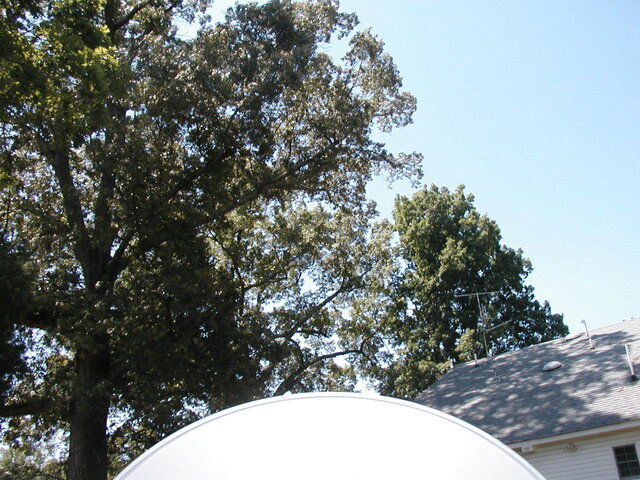

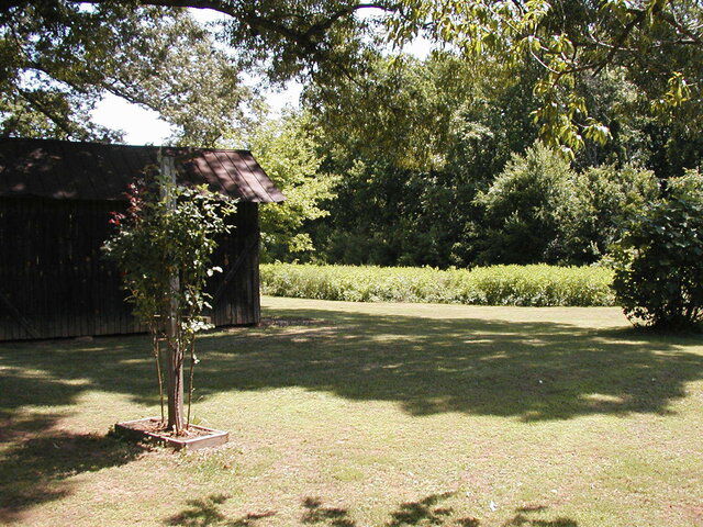

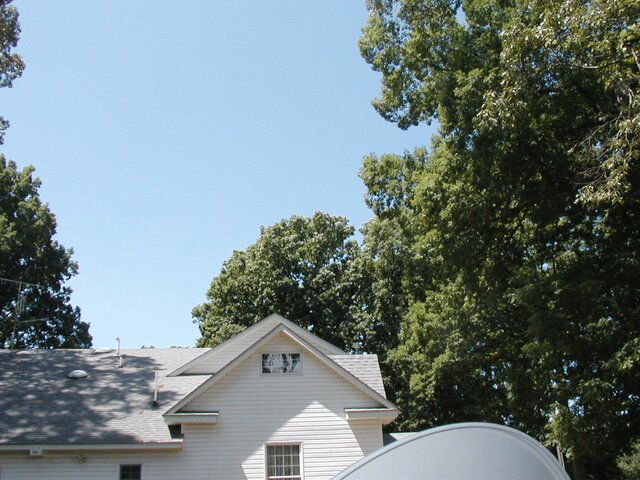

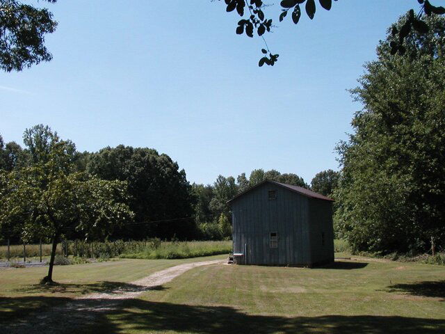

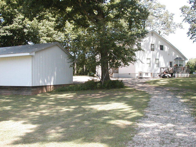

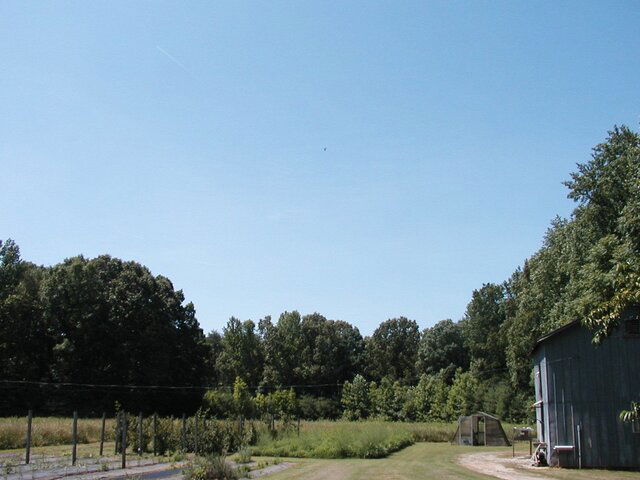

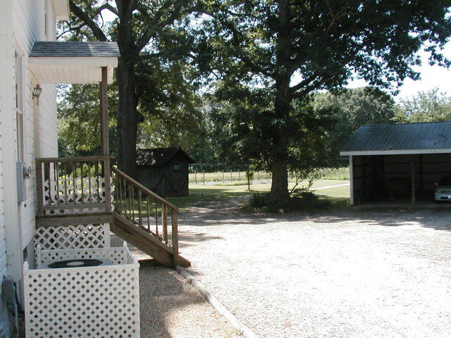

Okay, so here are some pictures. 3 is a view of that whole side of the house. Side porch, garage, driveway, shed. 6 and 7 is standing right next to the tree next to the garage, looking over the roof of the barn. 8 is the great spot I picked out, and 9 is looking back at that spot. 10 looks back at the spot next to the tree by the garage, and if you look at the very right edge you can see the dish where it is now. (I was aimed at 97W for Al Jazeera at the time.)
12 and 14 are looking from right behind the dish at the view of the sky from its current placement.

N4MJC, Nice yard lots of space I wish I had that much space.
73
KJ4EUC
Thanks. :)

Trip,
The 3rd and 4th pix as shown in your post (#61) - pix P101007 and P101008 looking over the small barn looks like a great view. If that were close to the southern view, I would think that would be an ideal location to set a motorized dish.
RADAR
Trip,
RADAR
Those are actually two somewhat different locations. It is a southern view, I'm looking south-ish in both pictures. Not sure how far east it goes, but a few years ago I borrowed a friend's DirecTV system when he deactivated it because I wanted to see how my view was, and from that general area I remember having a good lock on 119W and that was aimed basically the same direction as I'm looking toward the barn in that third picture. So I suspect my western view is okay.
I know they'd be good locations, but I'm just not sure I want to invest the effort to put something over there, which would include installing a properly installed pole (since the ground isn't flat there) and the burying of cable, since I will most likely be moving out again once I have a job somewhere.
