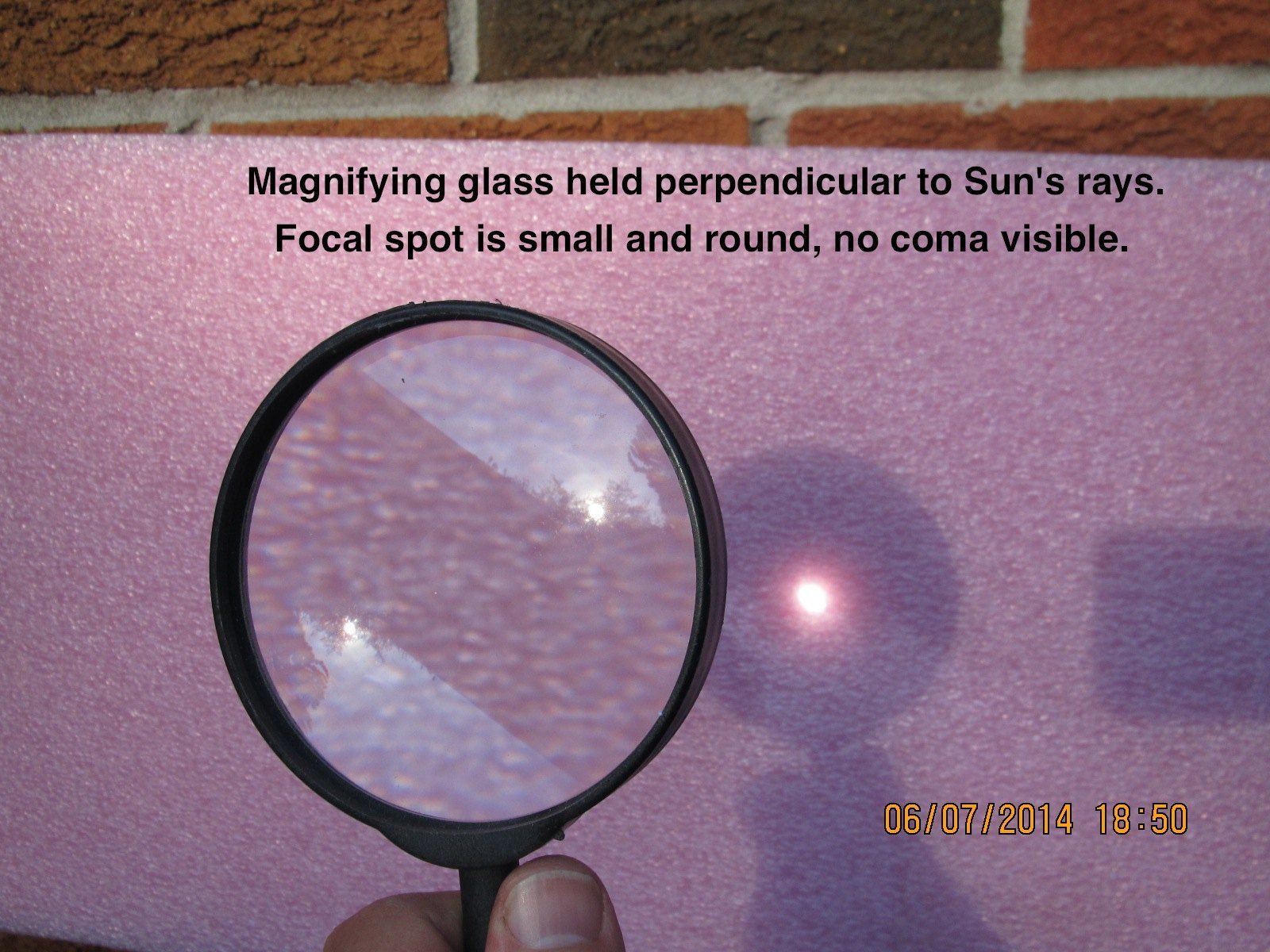

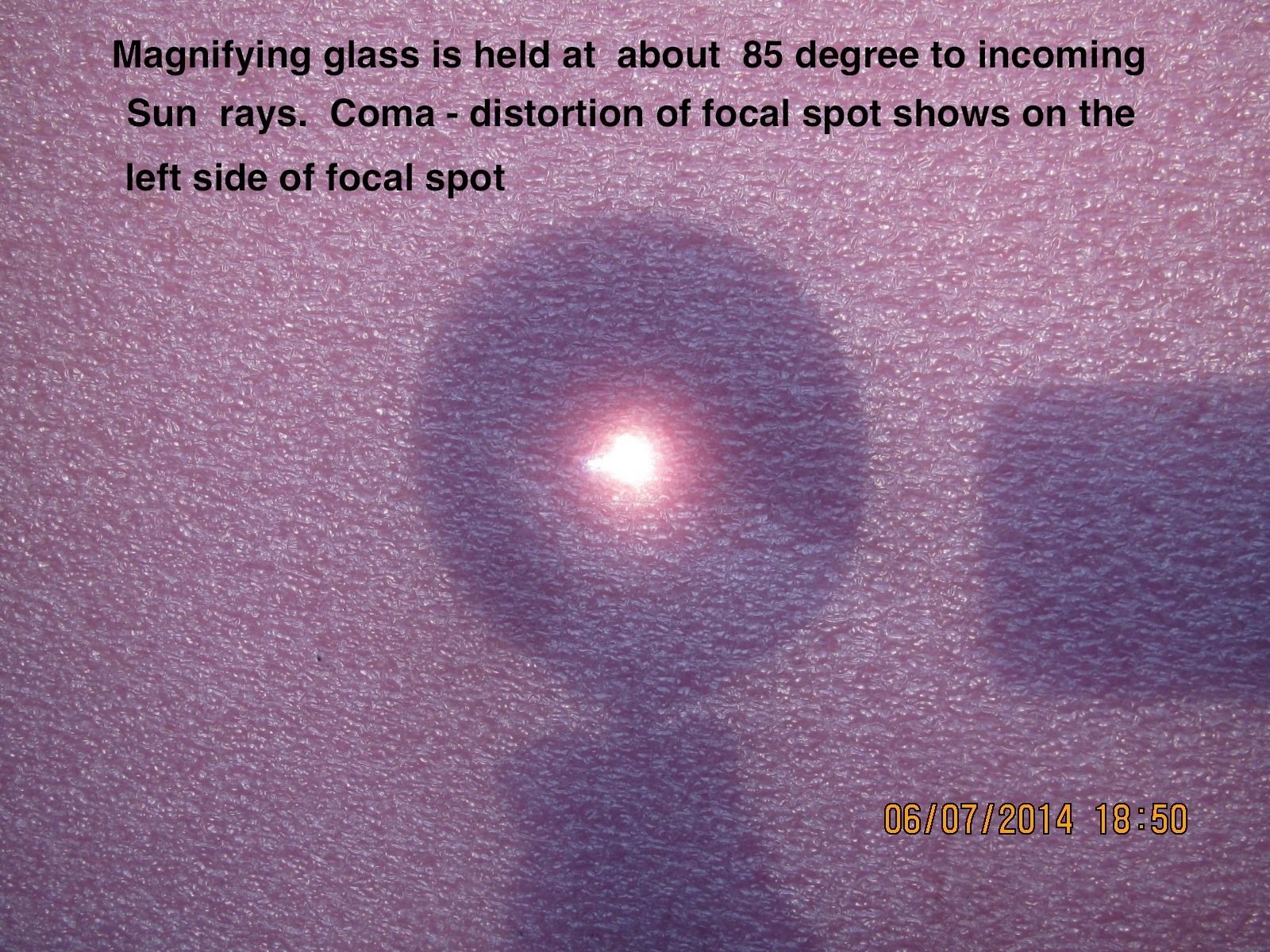

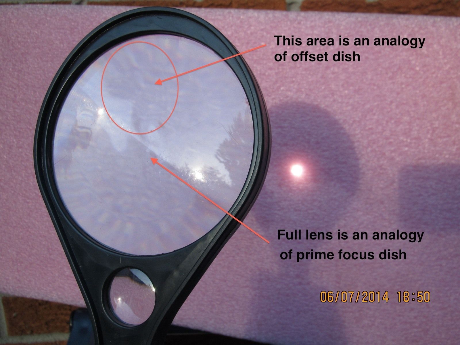

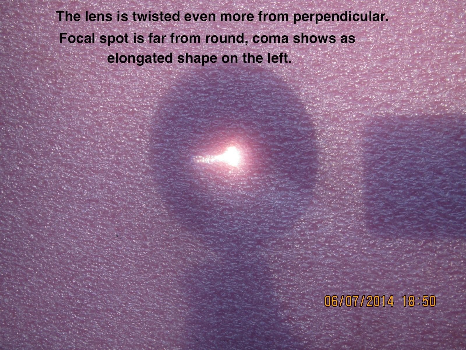

Took a few pictures with loupe and Sun light.
Tried to think deeper about this analogy, and comparison to prime focus and offset dishes, see photo 4, am I right?
Sorry, was not able to upload my photos, this recent change confused me. There is no option of uploading from computer,
maybe will try later
Upload a File is just beside Post Reply. Heads Up: There is no 'library' of previous uploads anymore.
Think you could 'visualize' the effects of an offset by covering the bottom half of the lens.(??)
Reactions: polgyver
Thanks, FaT Air,
Reactions: jorgek and mikelib
Exactly what I was 'visioning' I do believe a dish, either prime focus or offset, will 'act the same' with the signals from the satellite. Maybe not as extreme because of the lower wavelength, but the same non the less.
Without moving the lens in picture 4, but 'blacking out' everything outside of the 'offset' ellipse on the lens, the focused spot will be in the same place. It won't move. But the coma 'effect' will remain.
I tried "blacking out" everything out side of the 'offset' ellipse - no coma - unless I tilted the lens.
