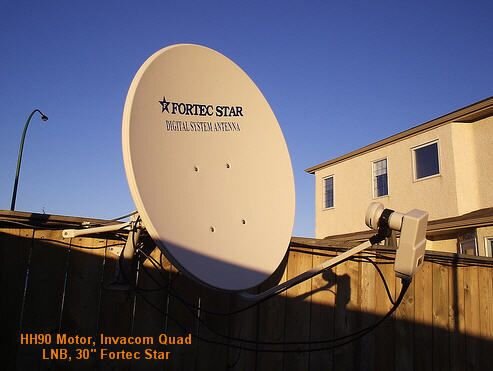

This is my first post at satelliteguys, although I have been lurking around the forums for quite sometime. Thanks to you all, I was able to get to this point.
Equipment: Motorized FTA system with Invacom Quad Polar LNB
- Fence mount (Initial pole mount did not work very well)
- T5/IA5 is true south
- Motor: Stab HH90
- Dish Type: 30" Fortecstar
- Location: Winnipeg, MB (Hash winter and windy city)
- Receiver used: Pansat 2500A
Note: I do not watch much TV, so a lot of my testing is based on documented FTA channel listing.

Question:
When using 4-1 diseqc the motor seem to get confused and move back and forth just like it has "no brains". I have to enter the installation menu and force it to cycle through various tp to have it stable on the specific bird. The following config have been tested and same results with the motor.
(A) Diseqc between LNB and Motor, Only 2 inputs on the diseqc used (L and C)
(B) Diseqc between Motor and receiver, Only 2 inputs on the diseqc used (L and C)
Diseqc used is a digiwave 4-1 diseqc that has the label "Power Passing: 500mA". Once I have the diseqc removed and have the wire pass through directly from Receiver to motor then to LNB, things work better and motor can move better and smoother.
I currently have a temporary fix with A/B switch controlling Linear and Circular birds. This is not the best solution, but for the sake of the motor movement, this is the best now.
Could someone suggest maybe a different type of Diseqc that would do a better job? A special kind of switch?
Thanks

If you only have the two lines to switch between, a 22Khz switch is nice. Don't have to configure any ports, just ON or OFF. I got one from Sadoun that has their name on it and it seems to be pretty heavy duty. All ports on it face the same direction, so you can mount it outside and have them all face downward.
welcome :wave
I know there are a few members here from Winnipeg so hopefully they can chim in. I'm in MN and can get most everything from 61.5 over to 148
AMC1 is screwy. The skew is off by like 25 degrees so the only thing you might be able to get is Pentagon channel.
I use a 2 way DMSi DiSEqC switch on my Invacom QPH-031 with no problems.
Thanks Das,
Do you mean this http://www.sadoun.com/Sat/Products/S/S-SM21H-2-way-switch.htm
