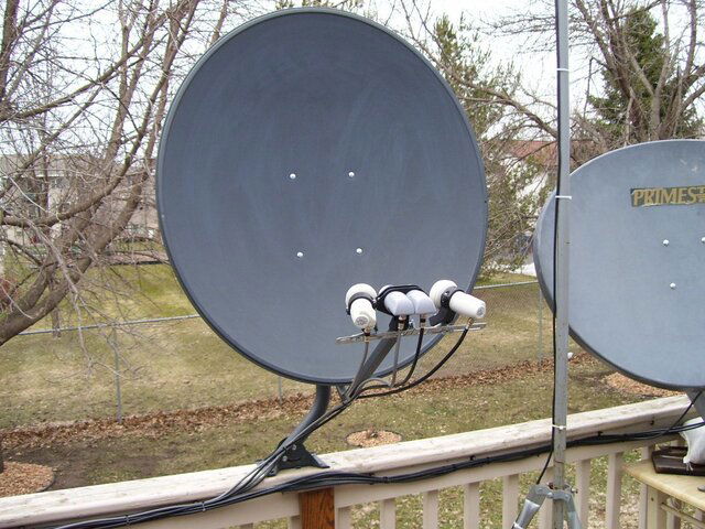

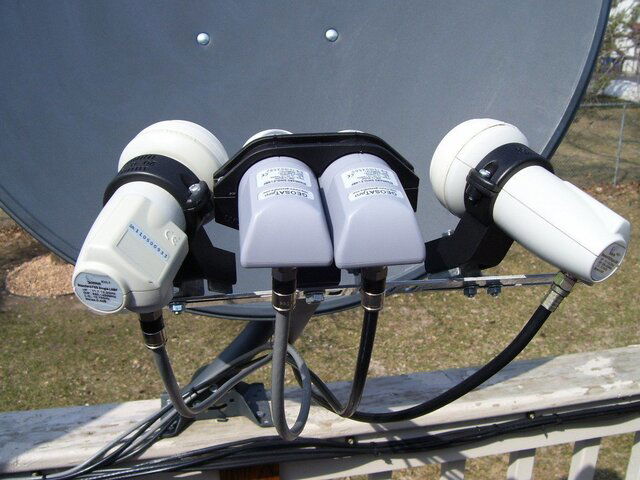

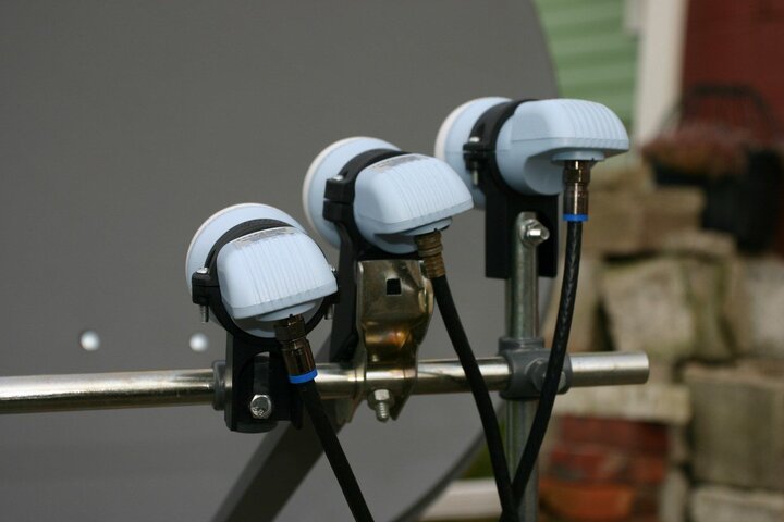

Here is my old 36" dish setup with 89/93/97/103 (from left to right)

Thank you Jim and Iceberg for the photos! I'm gonna try to experiement with each setup and see what I can pull. 103 is my main target and it seems like it must be an easy enough mod to get that bird.
Once again thanks for taking the time to take the photo and upload it!
