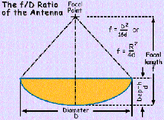

my C-Band LNBF is at 38 on the unit (so it sounds like yours). The LNB "eye" is about 3/4" farther in than the last scaler ring
Mine is a fixed dish at G4/G16
On my Fortech 6" dish, the measurement from the base plate in the dish to the bottom edge of the scalar ring is 29".
The lnbf protrudes 1.5" out of the scalar ring.
That seems to work best for the signal.
