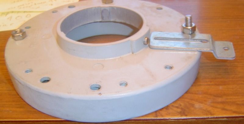

could you use spacers/ bushings to gain the 3/4 inch and longer bolts
mine allowed to adjust the arms inward and out and i ( push in "closer" push out "further") gained a little bit (didn't know if thats standard) but heres where i have the problem and need at least a day and alot of pacients to adjust properly lol
It's possible to put in longer bolts, or even all-threads and washers to extend out the arms.
The problem with that method is that all of that would have to be done on the dish side of the scalar ring, and might cause signal loss. It is also not easy to adjust for precise centering of the dish.
I have slid out the slots as far as they will go to get where I am. :D
I am thinking of perhaps an L shaped angle piece that bolts to the scalar ring on the cover side, and extends past the cover, then another L shaped angle piece with slots that bolts to the existing support arms, but when the two angles are bolted together, form an adjustable extension for the feed-horn to move it out further.
Just my first thought. :D
Fred
I have 4 of these little pieces laying in my shop. I hardly ever throw anything away. :D
I could either use them as is, and run all threads from the support arms to these guys with nuts and adjust them out.
Or put them in the vise and make them L shaped and turn the long piece upright, and get 4 other pieces to fit to the scalar ring bolts and extend out past the cover to meet up with these guys and use wing nuts and bolts for a sliding adjustment.
It can be done pretty easily.

I had stopped by Lowes on the way home, and bought some materials to make some brackets to extend my focal length to the calculated 34.5". So I spent the morning making brackets by hand. Took them up to the roof, and assembled them. I had forgotten that if you spread the support arms apart, it raises the feed-horn, so even with the brackets I had made upside down, the focal length was now at 37.5 inches.
I sat there thinking about how I could remedy the situation, and I took the piece that I had used in the picture the other day, and flattened it out, and made just a simple one piece extender for the support arms.
Put it together, and right now the focal length is at 34.5", but that comes right at the mouth opening. It needs to be inside about 1/4". So I will have to turn the bracket around, and fit it in the other way for it to adjust any further in.
The results for right now, no different than I had. I am hoping by hitting the sweet spot, I will see a change for the better.

Finally!!
I got the Focal length set properly at 34.5" like the calculator said it should be.
It increased the signal about 5 points across the board, so it was worth it. :D
I had to mount the support arms under the scaler rings to get it to that distance. Ended up not using any of my brackets that I so carefully hand made.
