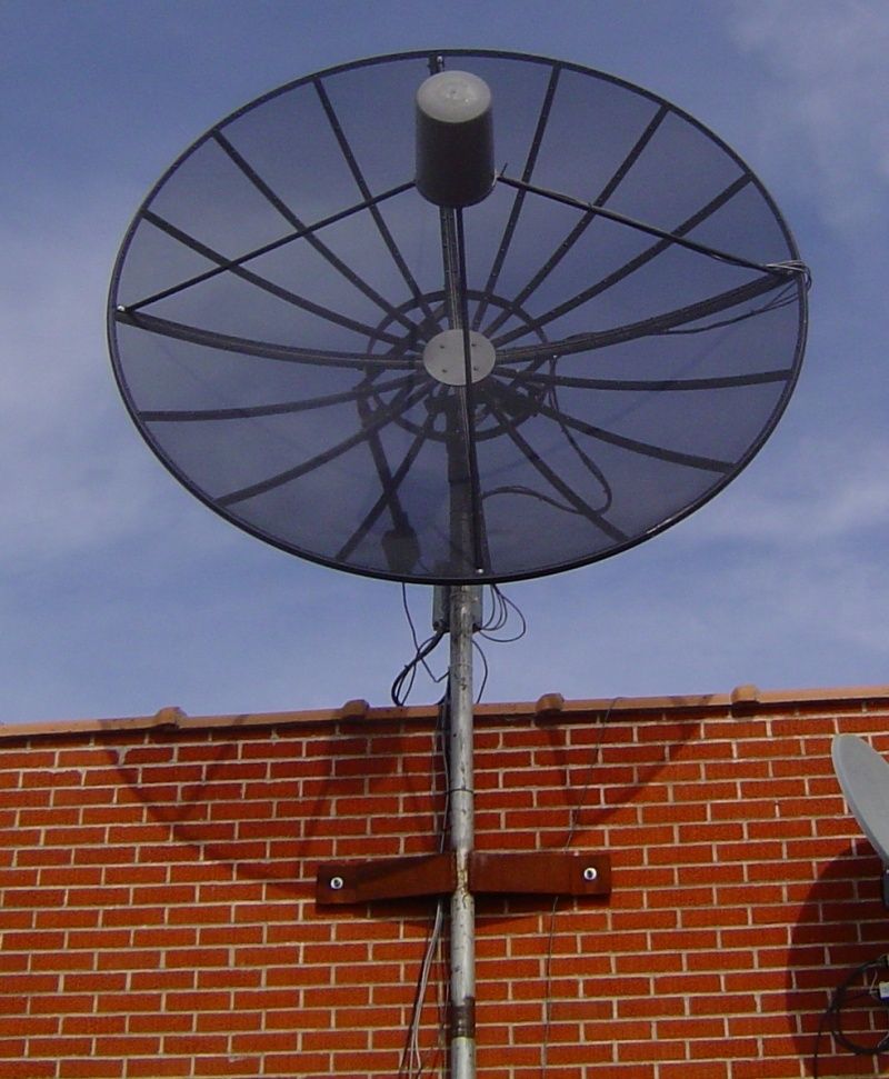

Here is the first picture of the refurbed Perfect 10 7.5 foot mesh pointed at G1/G15.
It got cloudy and dark out, so this picture didn't turn out very well. It is a little dark. I'll take better pictures tomorrow. :D

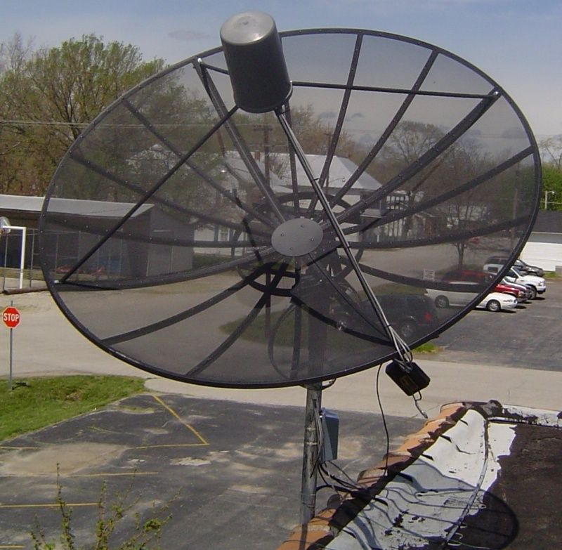

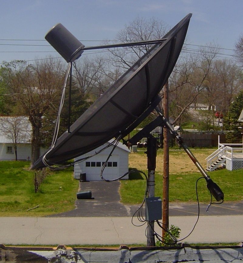

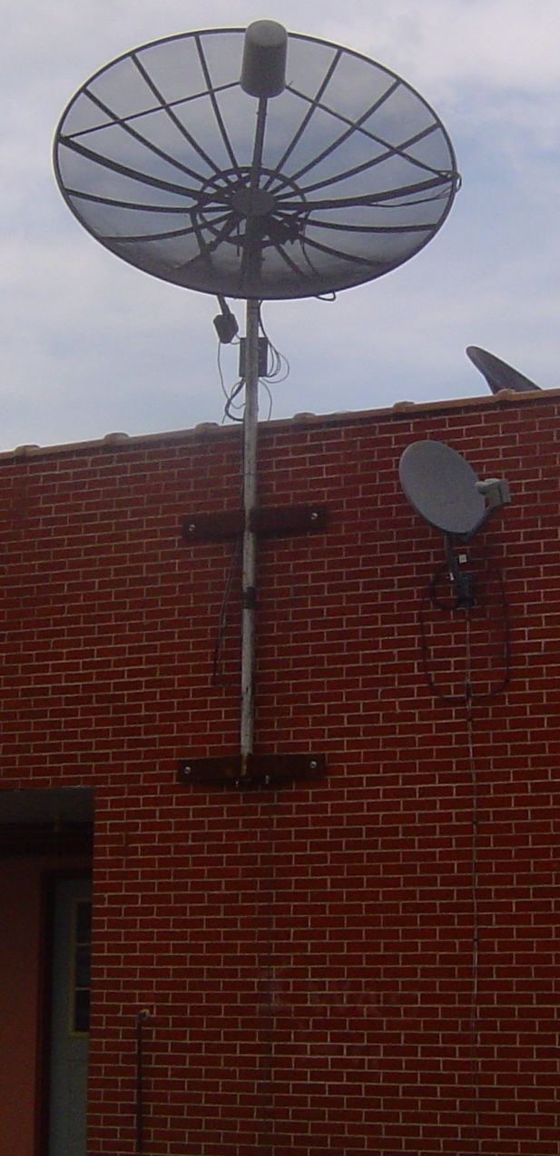

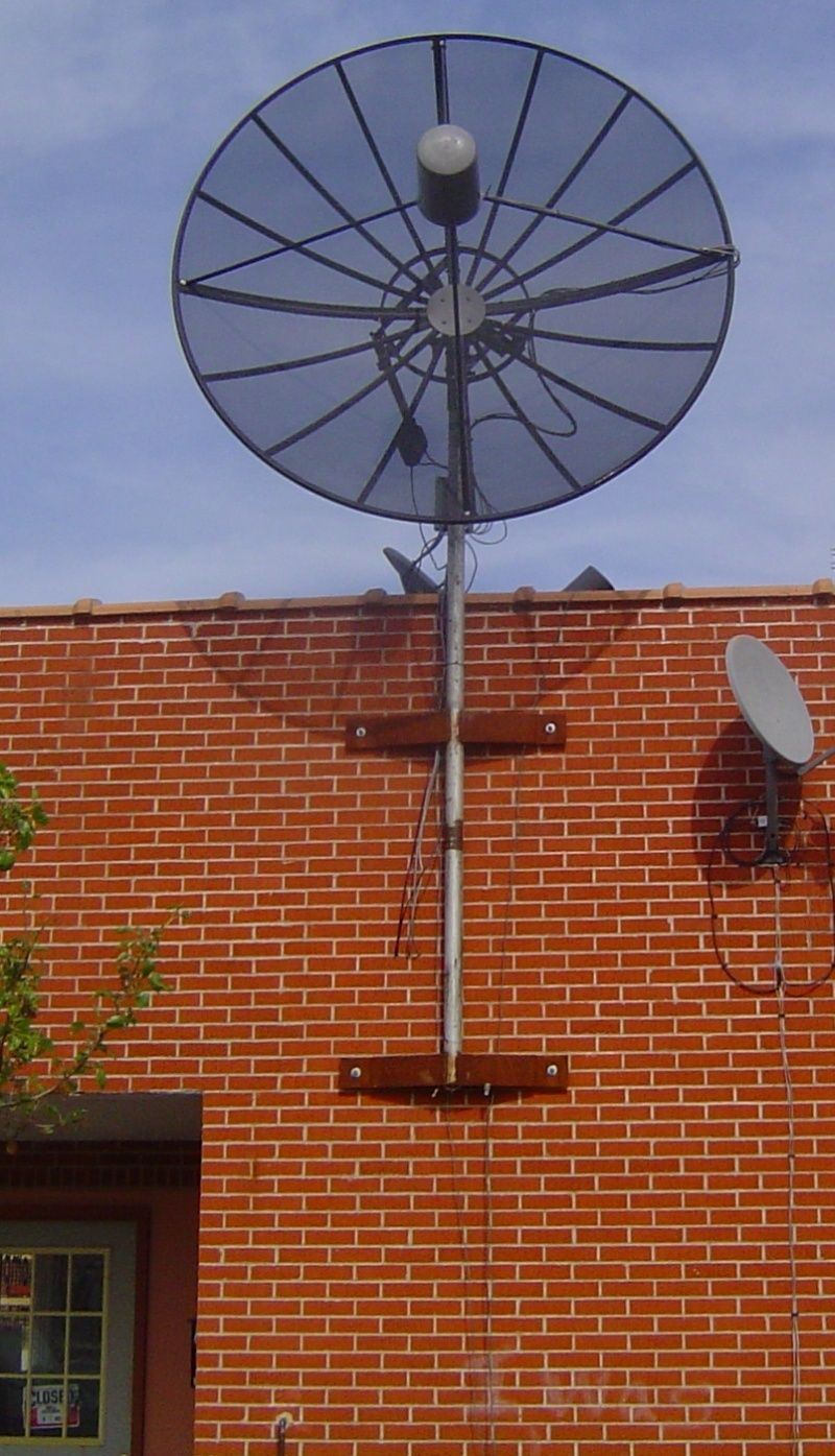

Took a couple of more pics today. They are better than the one yesterday. You can actually tell I repainted the dish. :D
refurbed-p10-mesh-west-limit.jpg refurbed-p10-mesh-west-limit-ground-level.jpg
