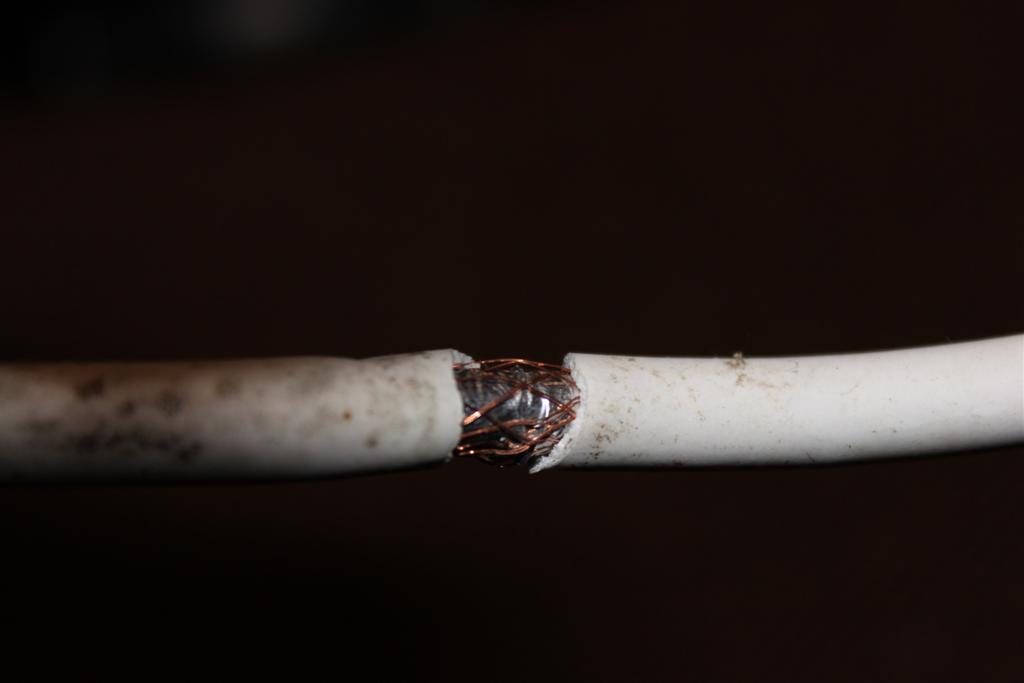

Didn't accomplish what I wanted to do with the universal Ku so I'll put the standard PLL LNBF back in. Was trying to get the NBC mux on 103 to work, for some reason it doesn't matter what I do it just won't. Great signal on the sat meter at the LNB but the Micro just doesn't see it. I am suspecting I have an interference issue, either on the IF side or the Ku side; or a bad piece of cable somewhere. It's should be good cable (Commscope/Times Microwave) but you never know...
Found the bad piece of cable. I thought it was the Commscope cable but looking at the shield under the broken jacket cover it certainly was not. Hopefully this will fix this and other issues...
