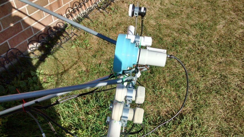

I had to make a custom mount for c band lnbf converting to c band from ku. I can line spot on but I am having worst lust with krbk that is the I want to watch. In way I had better luck with the 1 meter than te 1.2 meter dish.
Here are some of the pictures.

On a Channel Master dish with the 3 arms, any c-band lnb is going to sit high compared to a ku lnb because the arms interfere. You have to re-engineer the arms the allow it to sit lower, so it's centered in the beam.
As I found out recently, CM feedarrms and LNB holder designed in such a way than LNB is located not in antenna's focus and also not pointed to the proper point on the surface of the dish. So it is not so necessary to to place C-band LNB exactly the same way as Ku-band LNB was installed.
