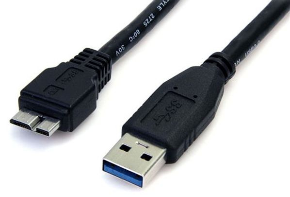

My next door neighbor has an external hard drive with separate power supply so I tried it and it is recognized by the 211k. So I do need an external power supply. Does anyone make/sell a replacement USB cord for hard drives that allow you to supply the power to the usb cord from an AC/DC adaptor? Attached is a photo of my current usb cord.

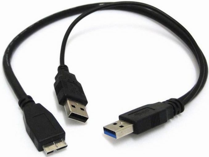

Well, I found the USB cable I needed without having to order a hub. It was only $4 on newegg.com I just have to plug its second usb connector into one of the many AC to USB power adapters I've accumulated over the years.
Thanks to all that helped.
Bob
Reactions: Foxbat and HipKat

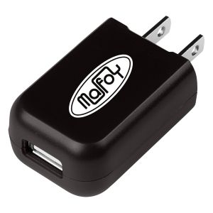

Well, the dual USB to hard drive cable I purchased (like most inexpensive computer accessories), shipped directly from china and took close to month to arrive, but it showed up today and I can now report that it works fine. Just remember you need an A/C to USB adaptor as well.(pictured below). While waiting for the cable to arrive I borrowed a powered USB hub and it worked too, so I can confirm that either option will power an external drive that does not have it's own power supply.
