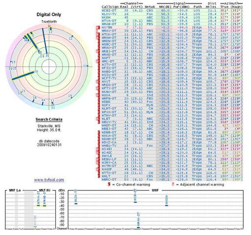

I have two HD DVR's (HR20). I live in a market where Dish and Cable both carry HD locals but DTV does not. I have tried every antenna imaginable apart from installing a lightning rod on the roof to pick up locals in HD...I can get only one consistently (CBS from 27 miles away).

No, the DirecTV receivers will only tune OTA ATSC channels, not any cable channels since they use a different standard. Have you checked AntennaWeb or TV Fool to see what types of antennas they recommend for your location and what direction they need to be pointed towards?

As far as the antenna goes, don't forget things like pre-amps, the make a huge difference. Your networks may be a combination of VHF and UHF, are you using an antenna that can do both?

I'm in the Tupelo, MS market (actually Starkville), about 80 miles from either the Memphis or Jackson locals market, which both have the HD locals. I asked a rep about our area and he had no clue. Guess I'll just continue boycotting NBC, ABC, and Fox since they stupidly think I can get their signals.
I checked Antenna Web for my address. It indicated I could get these locals OTA with a flat multidirectional antenna and preamp. Bought one for each TV and the best I can get is 55% signal with CBS HD IF there is no rain within 600 miles! LOL on the 600 miles part.
You can move to either and be in beam. HOWEVER, based on this current info shown, at under 30m, with the correctly selected and aimed UHF/VHF combo OTA antenna, you should have no problems getting your OTA signals. Not sure what a "flat" multi-directional means, but you need something like this - mounted above the roof line.
