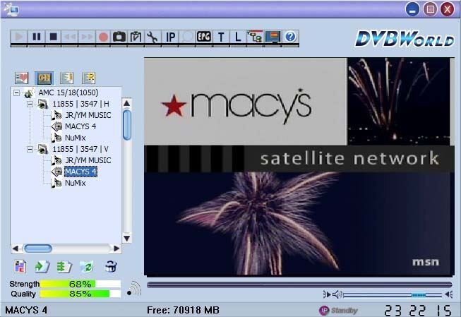

I finally got around to install my 2104D USB receiver. When I scan a satellite, it scans in both the H & V side of the same frequency. What am I missing here?:confused:

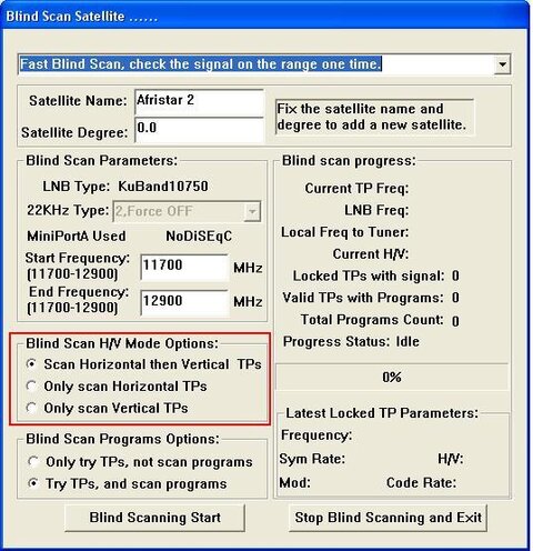

Are you using a different receiver to control the polarity?
If so then you have to tell the DVBWorld receiver to only scan one polarity.

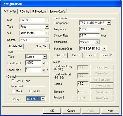

How can I edit the satellite configuration on the 2104D? After, I scan in channels, the satellite configuration parameters are grayed out. I should be able to change L.O. frequency and port settings on demand after I scan a Sat.:(
What I do (with a 2104C) is scan a transponder with no signal, the scan window closes on its own, reopen it, and then I'm able to access the sat config parameters again.

I now have a new problem. For some unexplained reason my Linear Sats are not displaying, but the Universal KU are showing fine. The Linear Ku channels scan in fine, but when I choose a channel the Quality and signal meter go from Green to RED!!!:( I have checked the switch. Used the same cable that I used with the 2104D on my AZbox & Coolsat 5K and all channels work fine. This same setup worked last night on the 2104D!!!:mad: See my first post. I have tried everything, but only the Universal from my motorized gives me signal and quality.
