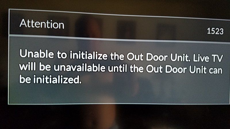

This is the error you get when the duo hub fails on a 2 Hopper3 installation. Had to go back to 2 single hubs and jumper.

It was outside by the dish. I figured it was the hub because when I unplugged the Hopper without the power inserter the other hopper would start working.

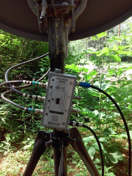

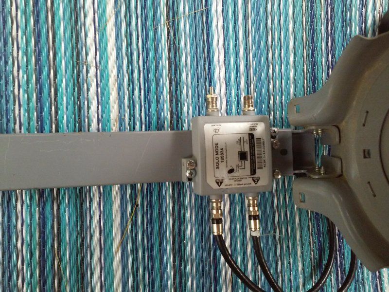

Here's how the Duo Node is mounted on the permanent cottage mount, and the Solo Node on the portable LNB arm. The blue coax on the Duo is a temporary connection to the RV when we're there, and that port gets terminated when we're gone. Anything I should be doing differently?
Reactions: charlesrshell
View attachment 133938 View attachment 133939
You just want to make sure that the cable runs downward so water runs away from the ports
