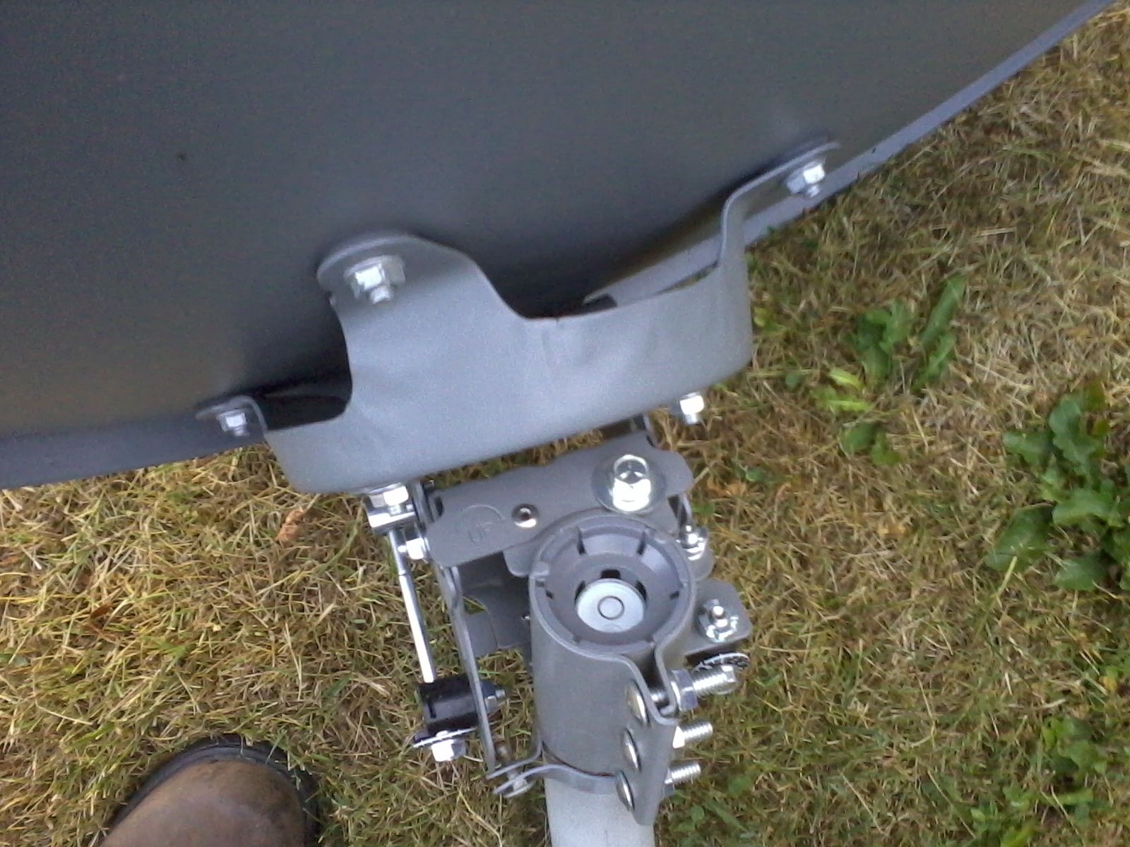

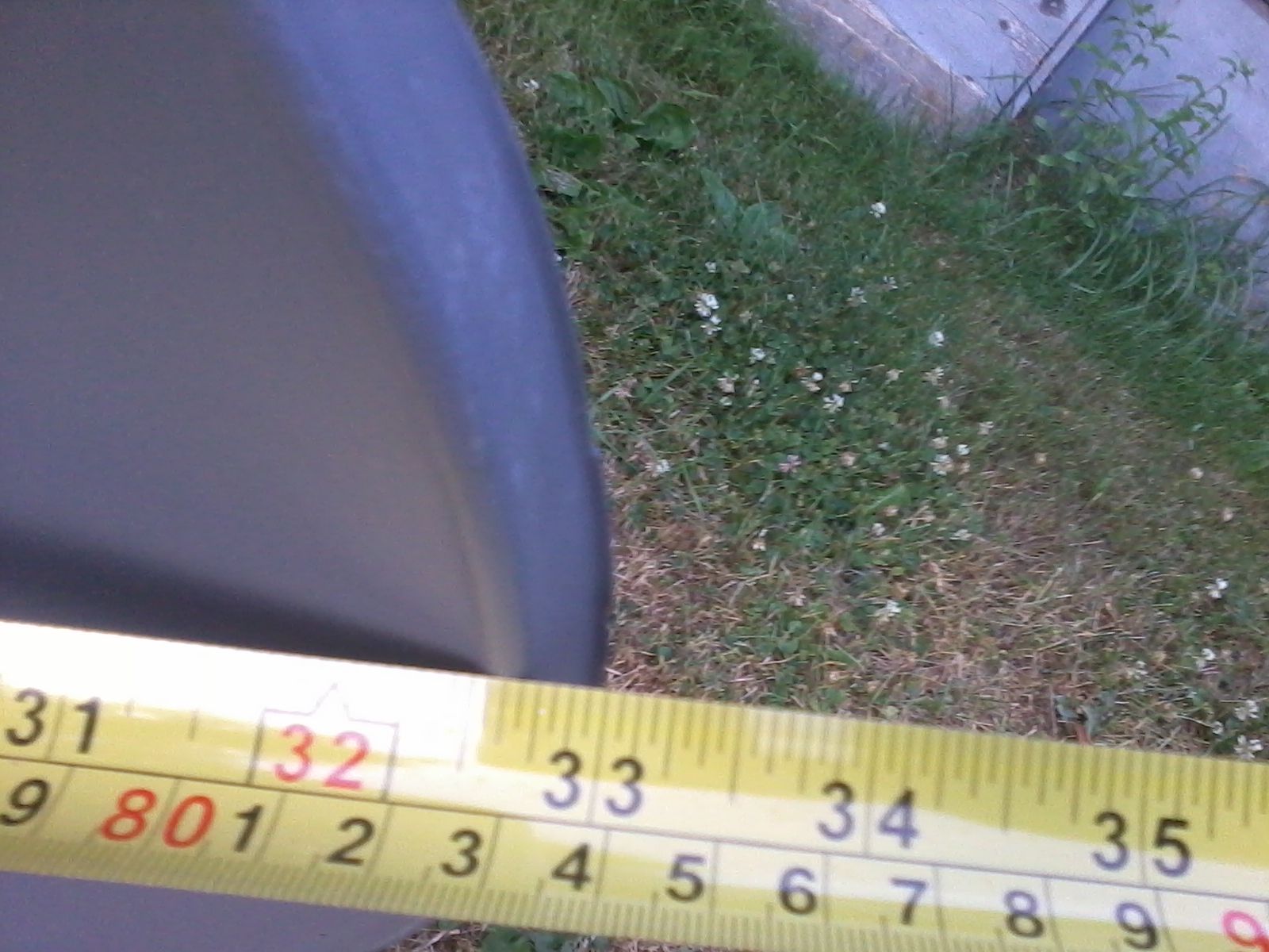

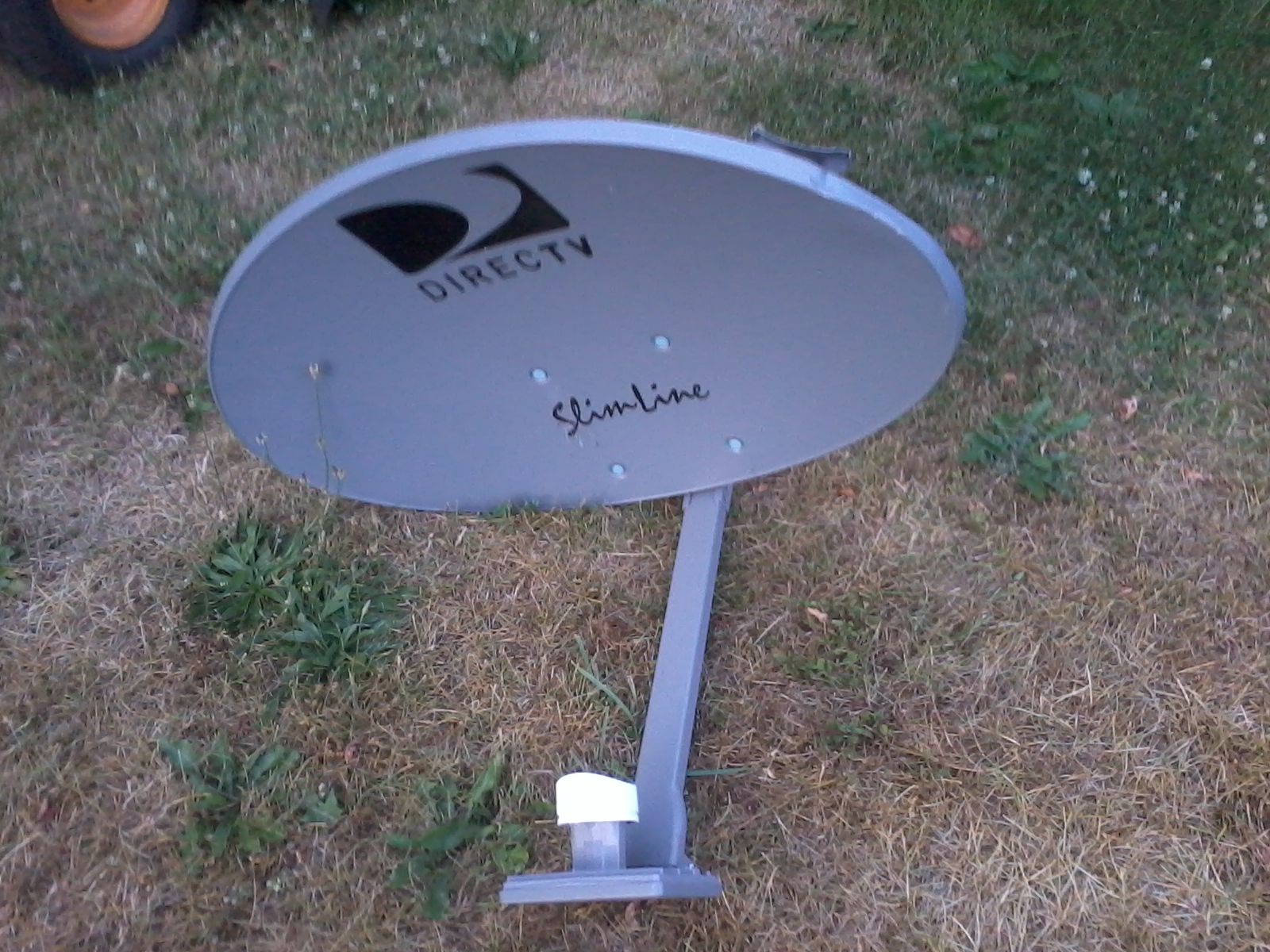

So a buddy just gave me his old slimline dish. It looks like I could get an arm and a lnbf attachment and I should be good to go. It is 3 to 3 1/2 inches less than my smallest prim star/ channel master dish which is 36. This slimline has some nice adjustments on the back.
So my question is, will this be suitable for galaxy 19? I have been trying to get a few people I know up and going with fta ku. Church members mostly. I have a spare receiver. So I was thinking eh, maybe.
Any thoughts? Doable? Not doable?

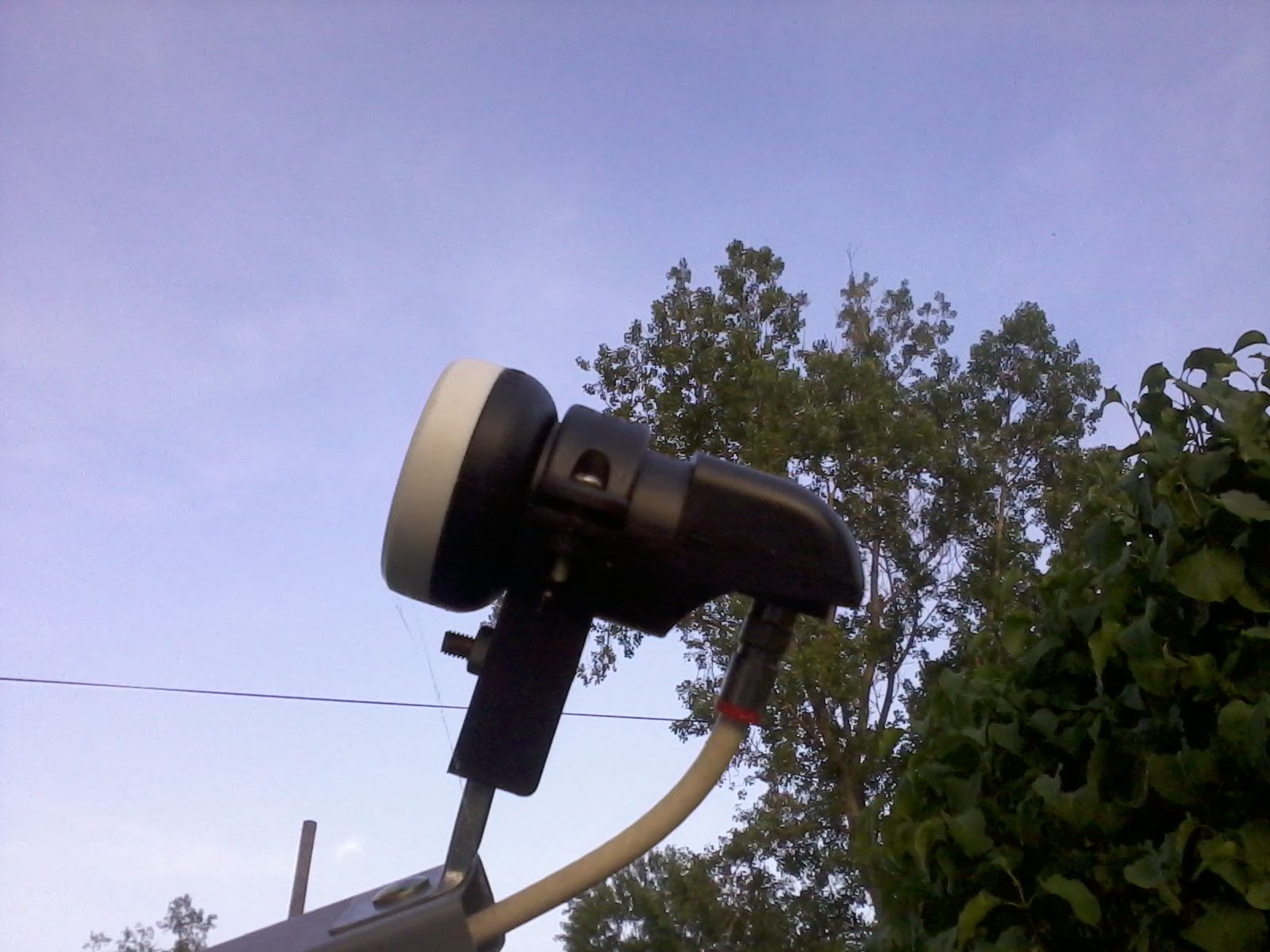

Here are some pics of the slimline. And some pics of my lnbf from one of my channel master
dishes to give an idea what I was thinking.

Yes, it's doable. Here is a thread about it (some nice pics in post #30). :)

I have a few Slimline dishes setup here for FTA and they work good on strong transponders.
