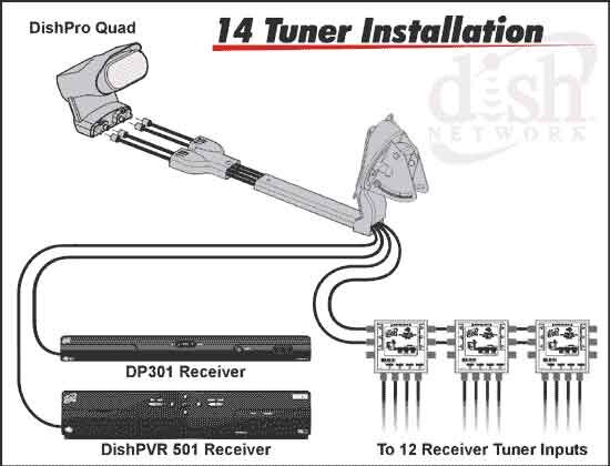

Microyal is not the same quality as DISH Network. DP34s are cheap enough on Ebay that there is no need to buy off brands. There is no DISH PRO compatible switch that is 2 in 8 out, what you do is use 2 DP34s.:)
