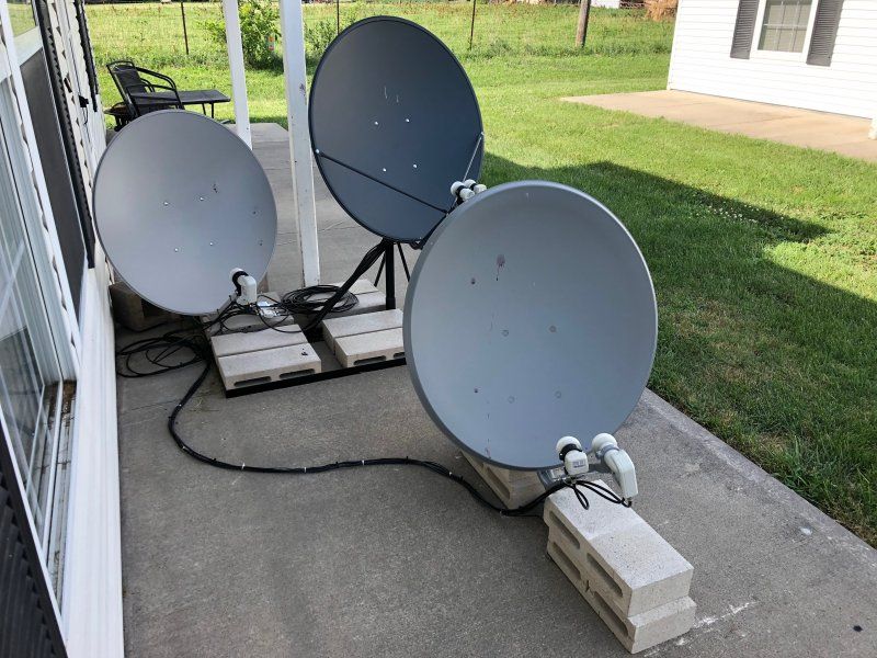

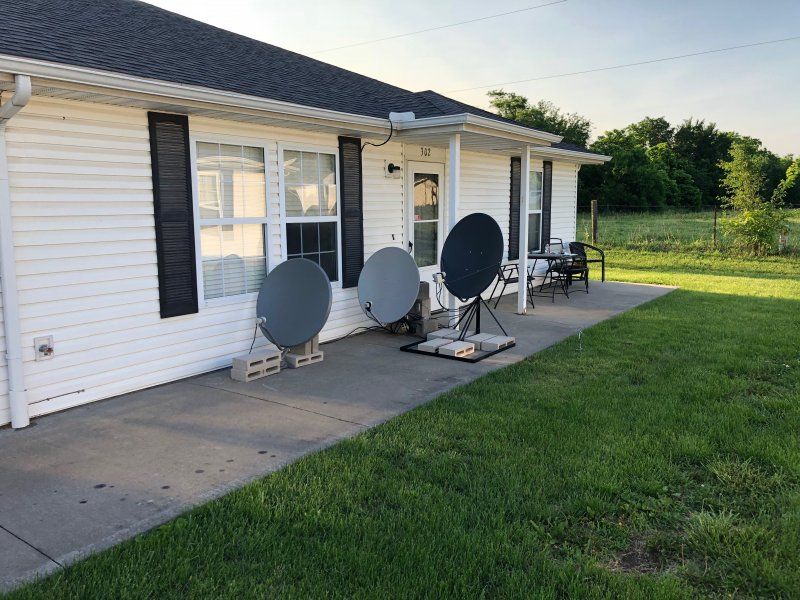

The other night, we had another freak thunderstorm at 2:30 AM. With cross winds over 50 MPH, it knocked my 76cm roof dish out of whack. I don't mind climbing up there, but I'm also becoming nervous that one of these storms will pull the dish and mast off the roof and cause much bigger damage.
The old 1000.2 retrofit dish is so small and close to the surface of the roof so it will stay (fixed on 95 W).
After spending a couple hours trying different locations, I was able to get all 3 of my bigger dishes on the ground with line of sight to 87, 91, 97 and 103.
The Winegard 76cm dish came with a large foot which my cinder blocks slid easily in to.
The neighbors are probably going to hate it, but oh well!

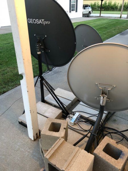

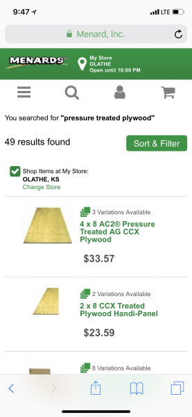

I think a better mounting system would be to take a longer sheet of plywood, coat it with never wet so it doesn't rot away and bolt/screw your dishes on there.
Thanks for the tip on Neverwet. I picked some up at Menard's for $9 and treated the plywood with it. Will be interesting to see how it holds up over time

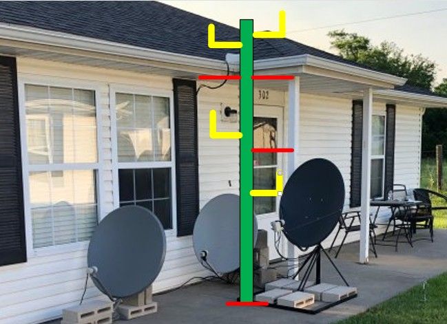

TBH, I do not like antennas places on the ground mounts. I would probably fix vertical pole ( "gree" metal tube 80x80x4mm) in the position, anchor it in several places (red lines). And then it would be possible to attach as many dishes as you need by specially made movable hooks (yellow). View attachment 133403
I like your diagram; how did you do that?
I wish I could do as you said and mount a pole; unfortunately I don't own the place and I can't penetrate any surfaces of the building or the ground. So it's ground mounts and cinder blocks for as long as I live here :)

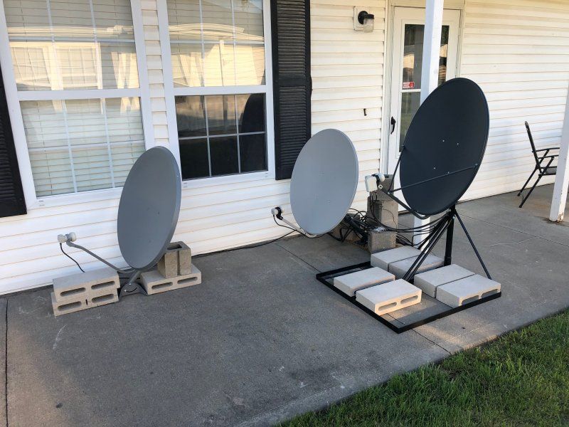

I like your ground mounts; very neat and orderly. Nice flat concrete pad. More shielded from the weather vs the roof mount. No downside to this.
Best thing about these mounts is that if adjustment is needed, no getting on ladders, lugging tools to the roof (and inevitably forgetting to bring a tool or two), wearing out the knees, etc. More freedom to tinker also since it's right outside the house.

About the only downside is that I can't see anything west of about 113, since the building is in the way

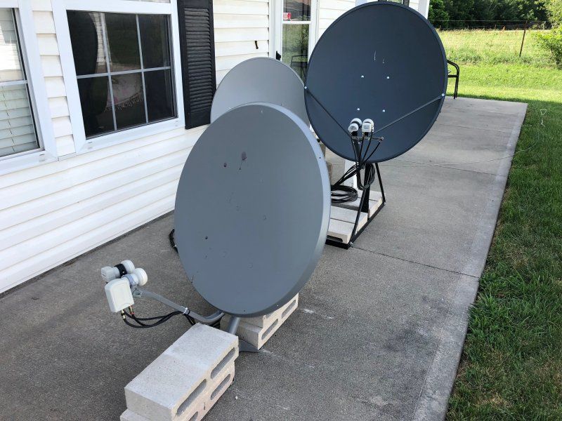

I did some experimentation this afternoon to see if the Winegard 76cm could handle an offset bracket. The idea being that I could put 95 on as an offset and get rid of the 1000.2 on the roof. It's not fun climbing up there to do maintenance, especially when it's 97 degrees outside like it was today.
Anyways, I was successful in getting similar signal quality on 95 by using the offset on the Winegard. I had to bend the bracket slightly so that the offset LNB lined up with the main LNB.
So now my dishes are all on the ground and easy to get to. And more protected from wind and storms.
