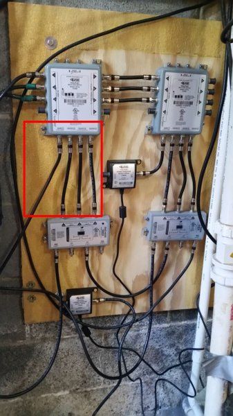

All of my own inside wiring is made with the PPC Belkin outdoor connectors, the only un-changed connectors at this point are on the cable too/from the dish, and 1 leg to my basement hopper which also services a single node, with a joey at the end.
(I did search the forums found 14 posts from 2008 ~ 2011, mostly in FTA threads)
3hopper_w-sling_1joey_spaghetti-jpg.127839
(red box was where badly made cables had too short of a lead)
There's the cinder block wall ... one cable, that was to my 3rd hopper, wasn't attached while I was trouble shooting, it was in direct contact with the cinder block for about 24 hours. It was freshly made, and in 24 hrs the head was corroded.

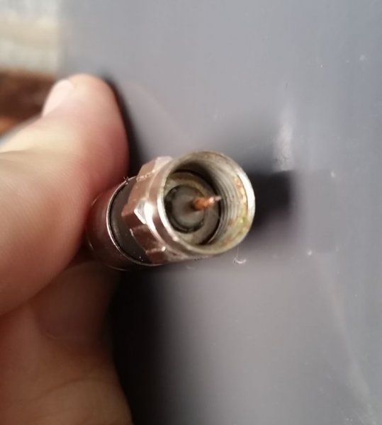

and *no, it was not "in" water... the best capture I could manage quickly, the center is pitted, and had an arc corroded lead with electrically attracted (?) deposited gunk, rust-like particles. You can see the inside threads of the head with discolored areas, so obviously the 12v / 19v ? power from the 3rd hopper was making its presence felt.

No no, while I was working to solve the wiring / switch issue, I had left the new room un-connected and unprotected at my switch port side. It was dangling there for about 16 to 24 hours. It was directly touching the cinder block wall, and the corrosion (this case) is simply a fact of leaving the cable connected and hot at the other end.
Remember these boxes (the actual dish receivers) put out 15 or so volts with current behind it to power the bits (lnb's, duo & single nodes, etc) Its the simple electrolysis caused by V+A+moisture. And that's what got me thinking even though tightening to (thought I saw) 30 lbs/ft which is supposed to make the connector water tight ... would the silicone dielectric even further arrest and protect from any moisture issues?
To clean off the corrosion, just dip a paper towel in cola and use that to wipe off the gunk. Make sure the cable is disconnected from any source of electricity first!

Time was short .. as to cleaning that head .. half to 1 dollar 2 inches of cable .. just snipped & snapped new head. Lesson learned about not leaving dangling cables, while the other side is energized.
