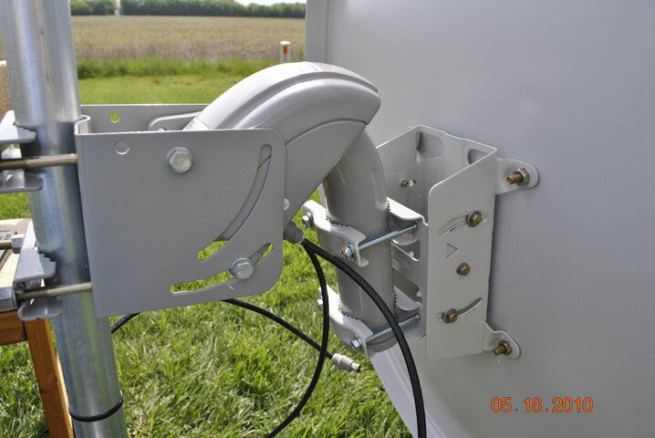

Here are some pics of my setup.

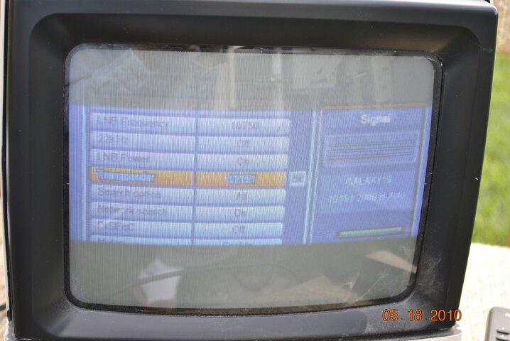

I can't tell in your Pic of the TV, but you should have the LNB Freq set to : 10750

LAK,under the Galaxy 19 list it DOES have a transponder of 12151 H 2000,do I enter that total number in the transponder box on the reciever or just the 12151?
Oh another thing I think I had wrong,I had the DISEQC set to port 1,im not using a switch,I only have one LNB so I will switch it to off.
Lot of learning but I think when I get the initial setup I will be off and running!
Make sure you have the SR entered correctly as well of the frequency. VERY IMPORTANT. It won't show you signal quality if not. In this post, you didn't have the SR for that transponder listed correctly. In that pic, it looks like the dish is aimed too low. Is the pole the motor is mounted to level on all sides?

Hi kspilot and the group, you can't give up now - just take a break and order one of those cheap satellite finders. After it comes in loosen up the dish elevation and sweep the due south satellite. The meter will not have any lag so you can move the dish quickly and find a satellite. The finder will work even if the receiver is on the wrong TP.
The dish elevation angle looks very low to me but I'm from central Florida.

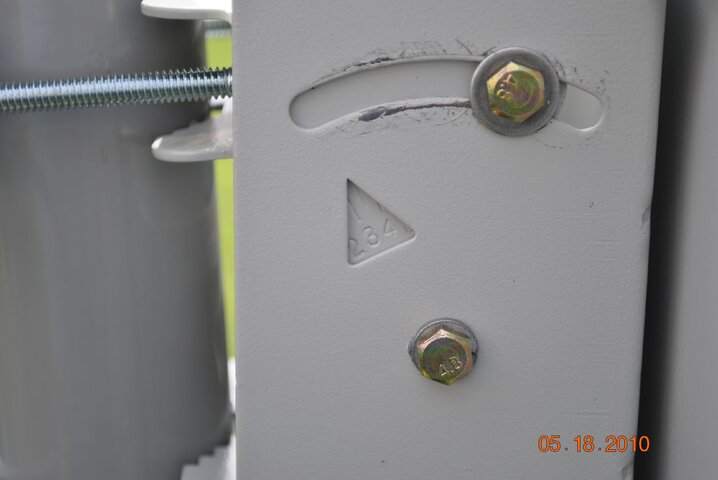

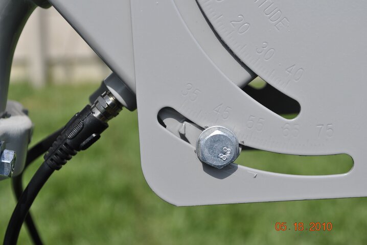

Im trying to figure if im pointing my dish in a proper way for elevation.
I have a SG9120 motor and a WS 90cm dish bolted to my mount pole,in the manual it has a chart that says with my longitude(37.8) I should have an elevation angle of 53 and a declination angle of 5.897,it also states that I should use 40 degrees for the motor arm bend,with that said what should the scale on the DISH be set at or angle towards the sky?
Also im trying to hit the 97W Galaxy 19 satellite and on dishpointer.com it says elevation of dish should be 46.2 degrees.
So with all that said what angle should I set the dish at?
As of right now my setup is pointing at 34 on the dish scale and I have the motor mount set at my Longitude of 37.

They observed that my dish was pointed low but the scale on the dish said it was right,well I tought about it last night and googled some setups of other peoples WS 90cm dishes and I noticed my bracket on the dish was upsidedown again!
I had it wrong the first time where I couldn't see the elevation markers,turned 1 bracket around where I could see them but that wasn't right either because I couldn't get enough elevation out of it,I went out with my homemade inclinometer and the dish was sitting at 24 degrees NOWAY would I get a signal from thats,after I took the dish off turned the brackets where they are suppose to be installed it back mount and took my inclinometer and measured along the bottom of the LNB support I set it to 34 degrees elevation,went back in the house not expecting to see any signal and to my surprise,I had 90 Quality and 98 on the signal but I was on AMC4 NOT Galaxy 19 like I thought I set the asimuth to yesterday but there was a program on and checked to be sure I was on AMC4 from lyngsat,AMC4 was 101w and needed 97w,went back outside and turned the the dish to the east a little came back in the house and had Galaxy 19 at 45 on the quality,I bumped the motor to the east a little more and got 98 on the signal and 88-94 on the Quality!
