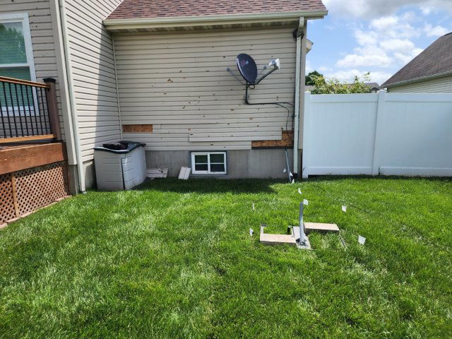

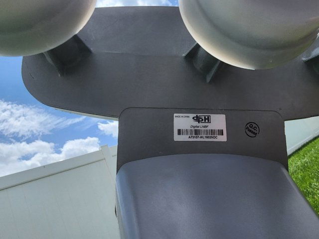

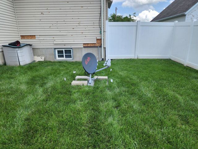

Dish stopped by today to install a pole mount. No one called Jule to mark utilities, he will come back for the pole mount next week after utilities are marked. So, he temp installed a 1000.2 western arc with three Hybrid LNBs. I told him that I needed DPP LNBs because I have a DPH42 switch that feed both Hopper 3s. He said no switch is required anymore that the 119 and 110 coax go direct to a Duo Hub. So, after he temp installed the dish we went to the basement to bypass my DPH42 switch and connect coax direct to my Duo Hub. He saw the switch and noticed it said DPH on it and said he doesn't need to bypass it. I said I didn't think the DPH LNBs shouldn't have a DPH42 switch in the mix. He said it was OK. So, we checked the Hopper 3s out and they both work OK with signal strength in the lower 70s.
Installers, is it ok to have Hybrid LNBs connected to a DPH42 switch? Both Hopper 3s don't have any problems so far. Will this cause issues down the road? Also, is someone at Dish suppose to call Julie to mark utilities for pole mounts or was I supposed to call them?

The DPH42 switch should be used with DP or DPP LNBFs, not DPH, it's on page 5 of the DPH42 manual.
Personally I'd ditch the multi switch and just use the hybrid duo hub, this will be a simpler setup because you won't need the power inserter anymore, and there's never a need for 2 wing dishes. (If you ever find the need for a single wing dish, that LNBF does have an input port).
Reactions: charlesrshell
He can't do that because the dual H3 setup requires the 42 switch. It's all about power insertion at the switch.
