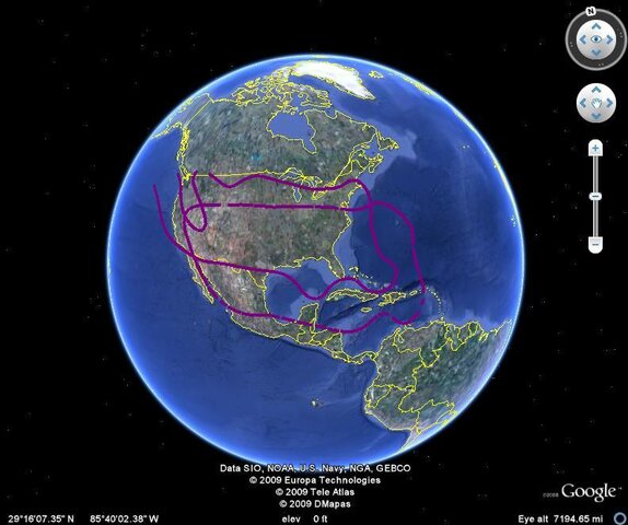

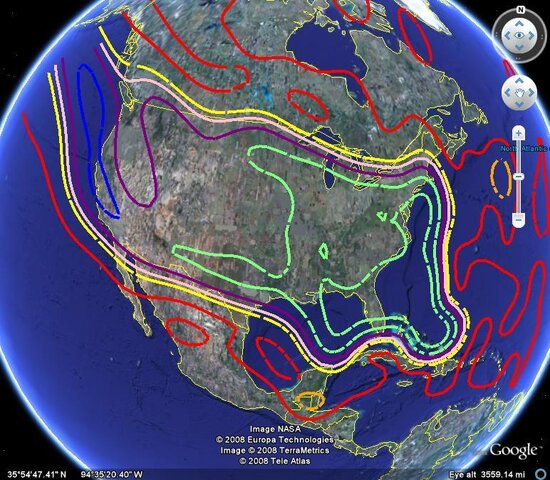

E1/E8 77W Footprints
Got the E1 77W footprint ( planned) converted ( US Beam).
It can be compared to E8
And, I overlayed the E1 and E8 49 dBw contours to provide an idea of the US service area from 77W using a standard dish.
The two together provide suprisingly good Conus coverage from 77W. Not bad for the second string.
