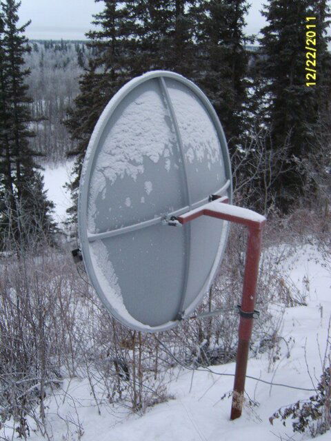

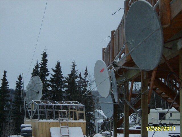

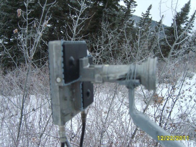

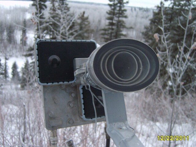

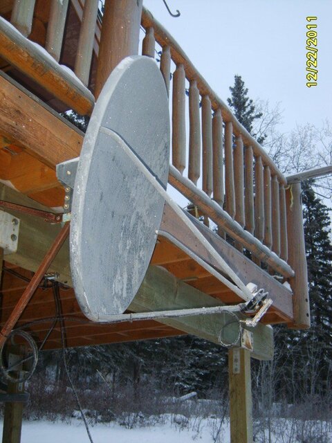

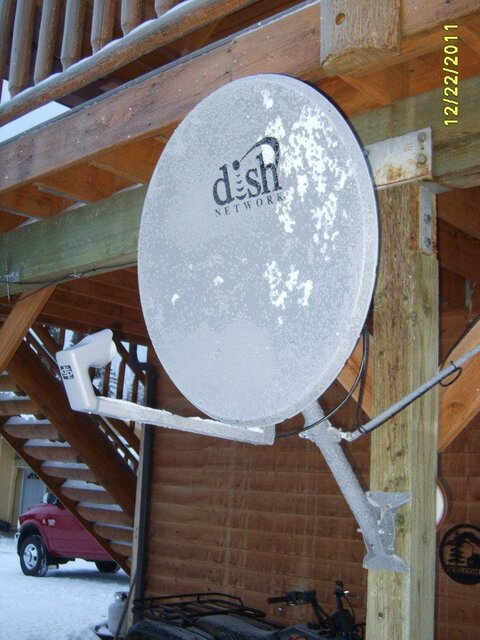

Here are some pics of my version of an Alaskan Dish 1000+ setup. 1.8M Andersen True Focus on 119 and 118.7, using a DP dual band LNBF from a Dish 500+ system. I stripped the cover off the LNBF, dishes were peaked with a Channel Master meter that I bought off the installer! This is a huge step up from my $15 tuning meters. On 110 is a 1 meter and DP LNB. 129 uses a 30" that the Dish tech installed again DP LNB. The 4 feeds run into a DP44 switch.

Snow will not collect in the dish, or on the feed either since we have real dry snow. Further south they use shields to keep snow off the feed. At work our C band dishes are 99% prime focus, and they DO COLLECT SNOW. We make many trips to the bush to remove snow if the locals don't sweep them out when the long distance goes out!
