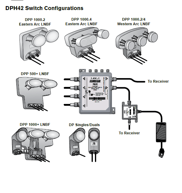

I recently graduated up to a Hooper 3 with one Joey. When the Hooper was installed, the installer installed a 1000.2 Dishpro Hybrid triple LNBF using the #1 port in the LNB with the #2 open. I'm wondering if it is possible to install a 211k using the second port in the LNB. I appreciate any insight.
Thanks guys. I kinda thought it was going to be a challenge and wanted to avoid putting up a new dish. I'm not sure if the Dish Pro plus is a new one. How would I know?
Bobby, would you happen to have a wiring diagram to show how the DPP+ and DPH 42 switch would be wired for my situation?
Here you go:
